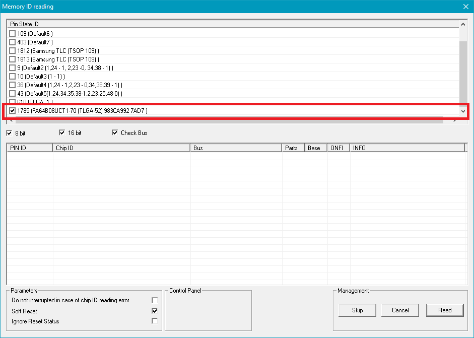

Try to chose power scheme ID=1785 during chip ID reading. Should help.

I can not found this power scheme
Posts: 770
Reputation: 28 / (280)
Re: Sandisk 20-82-00369-282
Postby Roman_TS » 29.01.18, 08:08
Here is it:

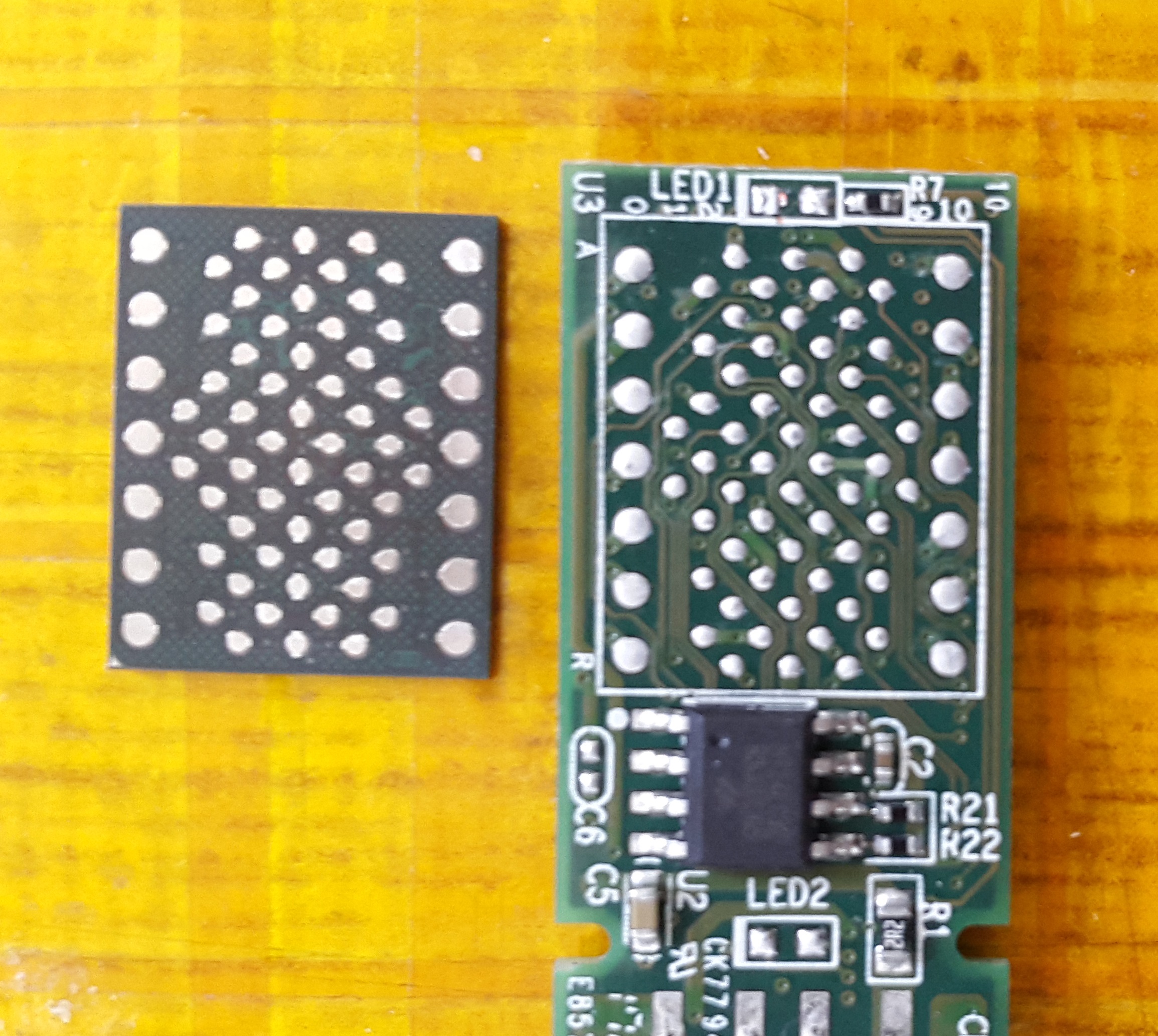

I also have an LGA60 Chip H23QFG8PG1MCS Manufacturer SK HYNIX.
I tried to read using power scheme ID=1785 with TLGA-52 adapter, chip is centered, clean contacts.
I get the following error.

MasterT wrote:Source of the post
A couple of questions:
1. Do you see chip ID in Log?
2. Are you sure that your chip LGA-60?
3. Did you turned off all other reading schemes like on my screen?
download/file.php?id=1025&mode=view

1. I cannot see chip ID.
2. i attached a picture for confirmation.
3. I did exactly as in your picture.

Most likely chip is dead.
Multi-COM
Posts: 26
Joined: 19.04.17
Reputation: 1 / (14)
Postby Multi-COM » 20.04.18, 21:45
Is this H2JTDG2MBR ? If answer is Yes then its probably not death.
