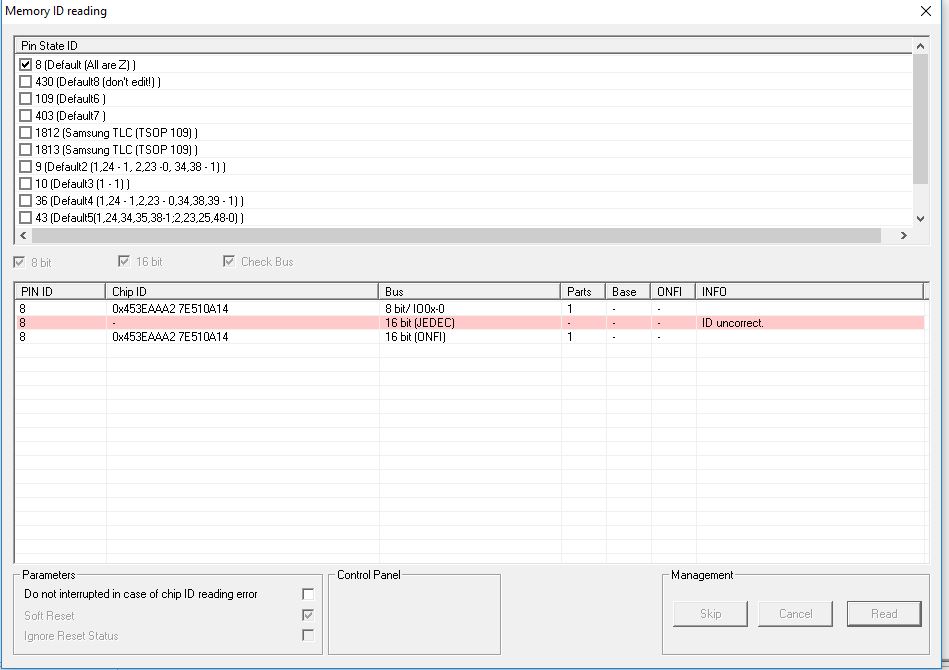

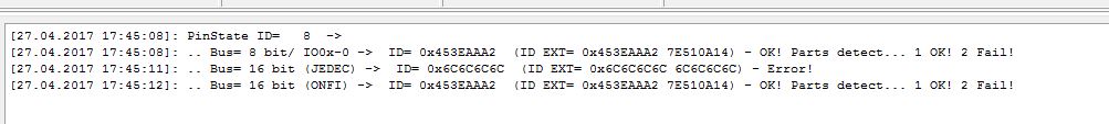

Are we adjusting only the: VCC channel- start value- setting?
If so, I have tried all the ranges from 2.6V up to 2.8V.
I still get the uncorrect ID in Jedec.
failed again.JPG (89.18 KiB) Viewed 12371 times
Re: VCC or 3.3V *Photo*
Postby Roman_TS » 02.05.17, 09:05
ID is reading, but looks like such ID is not in our database, because this is a new NAND, which we never see before. We have 0x453EAA92 in our DB, but 0x453EAAA2 - newer. It should appear in Flash during next 2-3 month.
