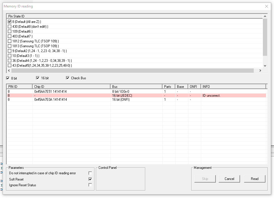

Everything has been connected according to the monolith pinout and I get the following error in the picture attachment. It seems one part is not reading.
I have verified continuity from of all the connections on the microSD to circuite board with a multi-meter.
It seems like it's being read correctly but the suite cannot find the appropriate parameters. Is this the case? What do I need to do?

And below is a picture of the error.

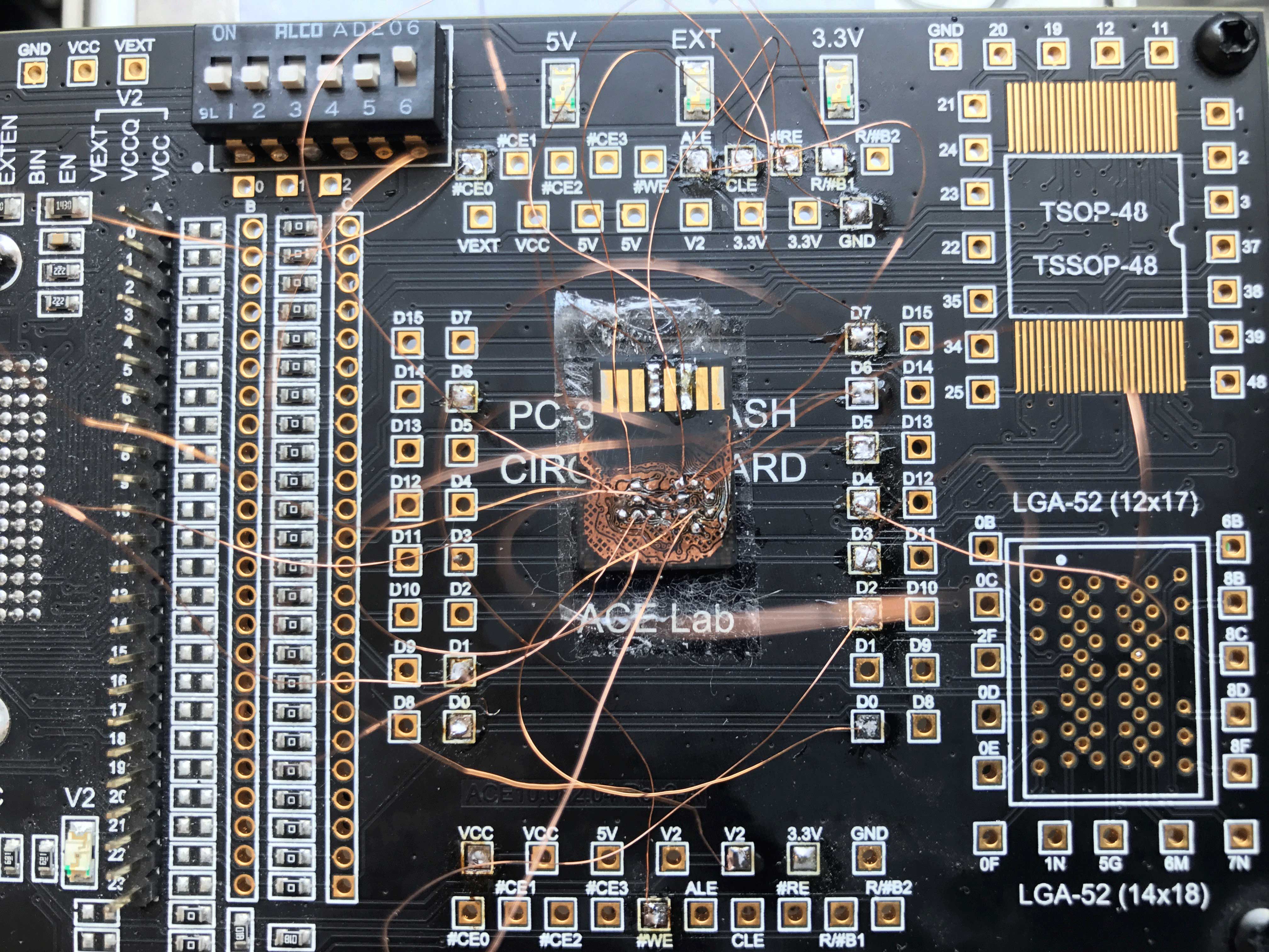

here are my circuit board connections

Soldering is incorrect. You need to solder VCC from MicroSD to V2 on Ciruit Board. You solder to VCC instead V2.
Also, triggers on Circuit Board should be set with following configuration: 1,2,3,4,5 - SWITCHED OFF, 6 - SWITCHED ON

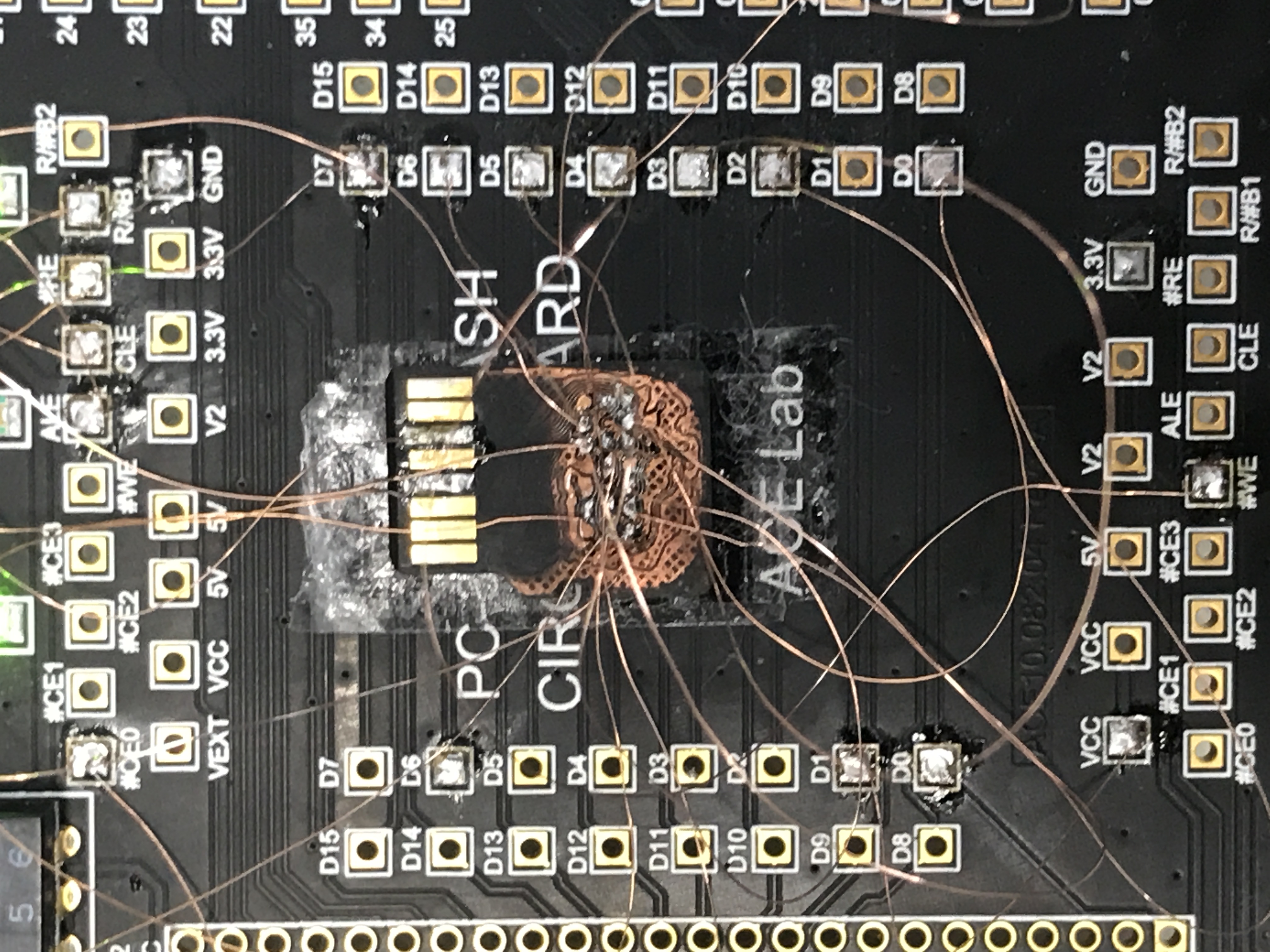

The switches 1,2,3,4,5,6 were all off and that is the way we worked with them in the course. Perhaps that's why it didn't work in when I was there. They are now set the way you instructed.
VCC on the microSD is now connected to V2 on the board.
The internet connection parameters are now set the way you instructed.
I still get the same result. 16bit (JEDEC) fails with "ID uncorrect"

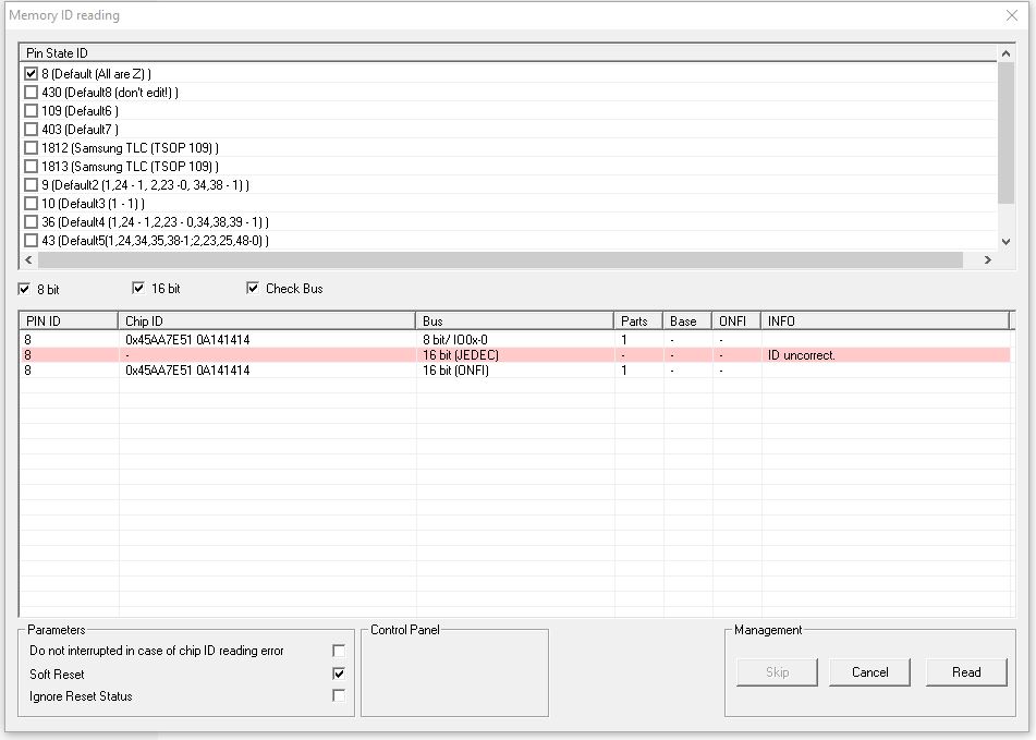

Updated photo:
After restarting the software it automatically did a download with the result: Ok CRC32 file! - "1" CRC = 3076174448
Now when I start the program it asks "repeate the download?"
Updated photo:
Re: VCC or 3.3V *Photo*
Everything is soldered well now. Check all pins with each other on Short Circuit, and make sure that everything is soldered correctly with microscope.

I right click on "Unknown chip" then "Read chip ID" and I still get the same "uncorrect ID" result.
"repeate the download?" it's for GSC - it's checking if there are new version available and if CRC is different from data you downloaded it ask to redownload but this don't have nothing to do with incorrect ID results - check soldering, especially if there are no shorts between nearest pins
