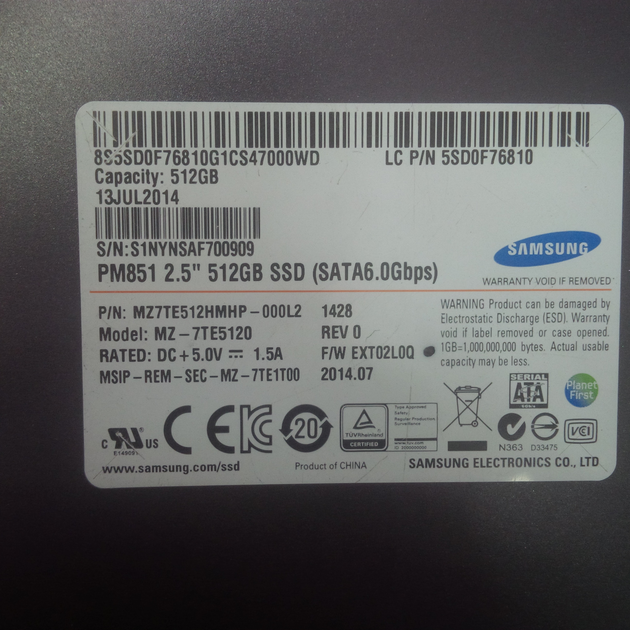

hello all,
where i can connect RxD and TxD signal for terminal on Samsung MZ7TE512HMHP 2.5" SATA PM851 Family ?
Thanks :D ,
Jinarto

Hello! Those two pins in the top of the board are the pins for terminal connection.
