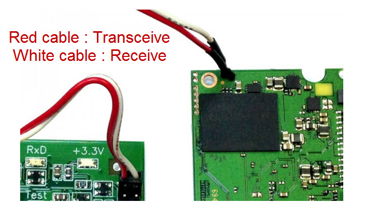

where i can connect RxD and TxD signal for terminal on Samsung MZ7TE512HMHP 2.5" SATA PM851 Family ?
PM851 Samsung need pin Tx and Receive pin
Re: PM851 Samsung need pin Tx and Receive pin
Hello! Those two pins in the top of the board are the pins for terminal connection.

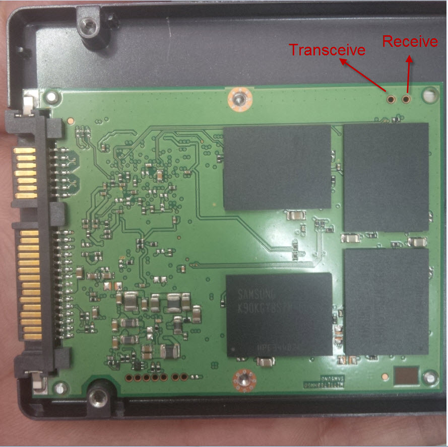

yes Mr. Roman.
which is TX and which is Rx pin ?
i show you in this attachment pic. if i wrong please correction. ok ?
Need to check it by yourself. Try both combinations. In Samsung Utility, should be a picture with correct PIN placement.
Nothing will happend. If you will connect terminal wrongly - SSD will not detect terminal.
