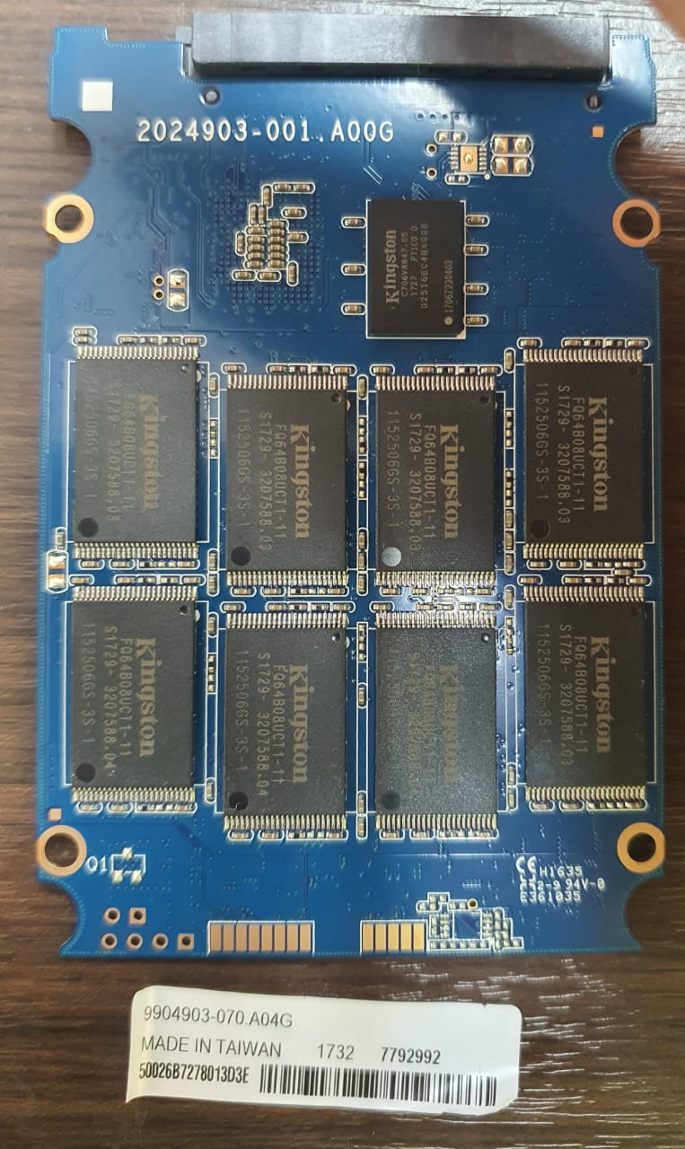

I have the latest pc3000 version 7.1
Kindly tell me the short pins and how to build translator
thank you
Model: SUV400S37/960G
Manufacturer: Kingston
Name: Kingston Technology
Capacity: 960GB
Cover Label:
SUV400S37/960G
9904903-070.A04G
7792992- 1732
50026B7278013D3E
Controller Label:
88SS1074 BSW2
TPP1220A JW
1721 BJE
TW

Every single manufacturer who is dealing with Marvell controller is writing its own firmware for each new model of SSD. As the
result, we should develop a new utility for every single Marvell-based case. Right now, we can work with the following models:
Sandisk SSD Plus
Sandisk Ultra II
WD Blue
All of them are based on Marvell 88SS1074. Other models, including the Kingston SUV400, I'm afraid, are not listed. Probably we will add them in the future, but I don't have any estimated time for now. Marvell's technology is extremely complex, developers spend around 18 months to add 88SS1074 support for these 3 models.

thank you dear Roman, you mean that my disk is not supported, right ?

Can you tell me please how to connect to usb adapter i want to learn

No, it's not supported.
