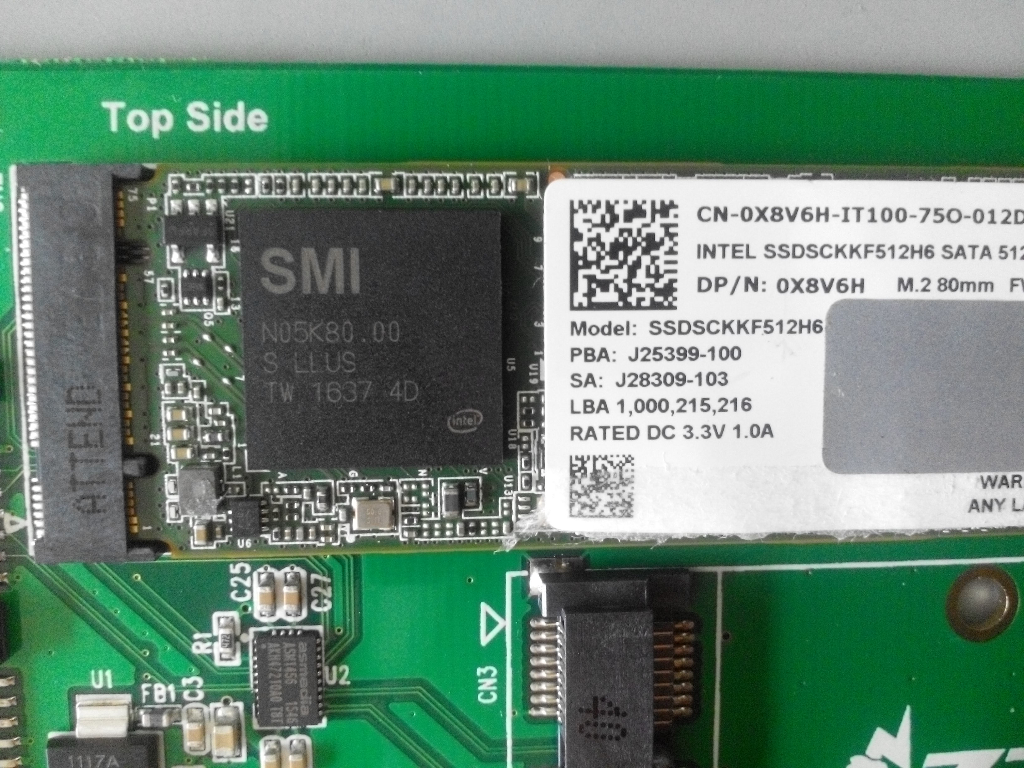

Dear TS,
Does the SSD supported by PC3K?
Model: SSDSCKKF512H6
Search on internet, it should be belong to SSD 540S, but the controller is not SMI SM2256EN but somthing like " SMI N05K80.00 / S LLUS / TW 1637 4D
picture is attached.
Re: Intel M2 SSD model: SSDSCKKF512H6
Postby Roman_TS » 25.05.18, 09:02
Controller is SM2258. Not sure when exactly this model will appear in support list because Intel totaly modifed default firmware of SM2258 Controller. We can't use default SM commands for TechMode activation on this drive.
