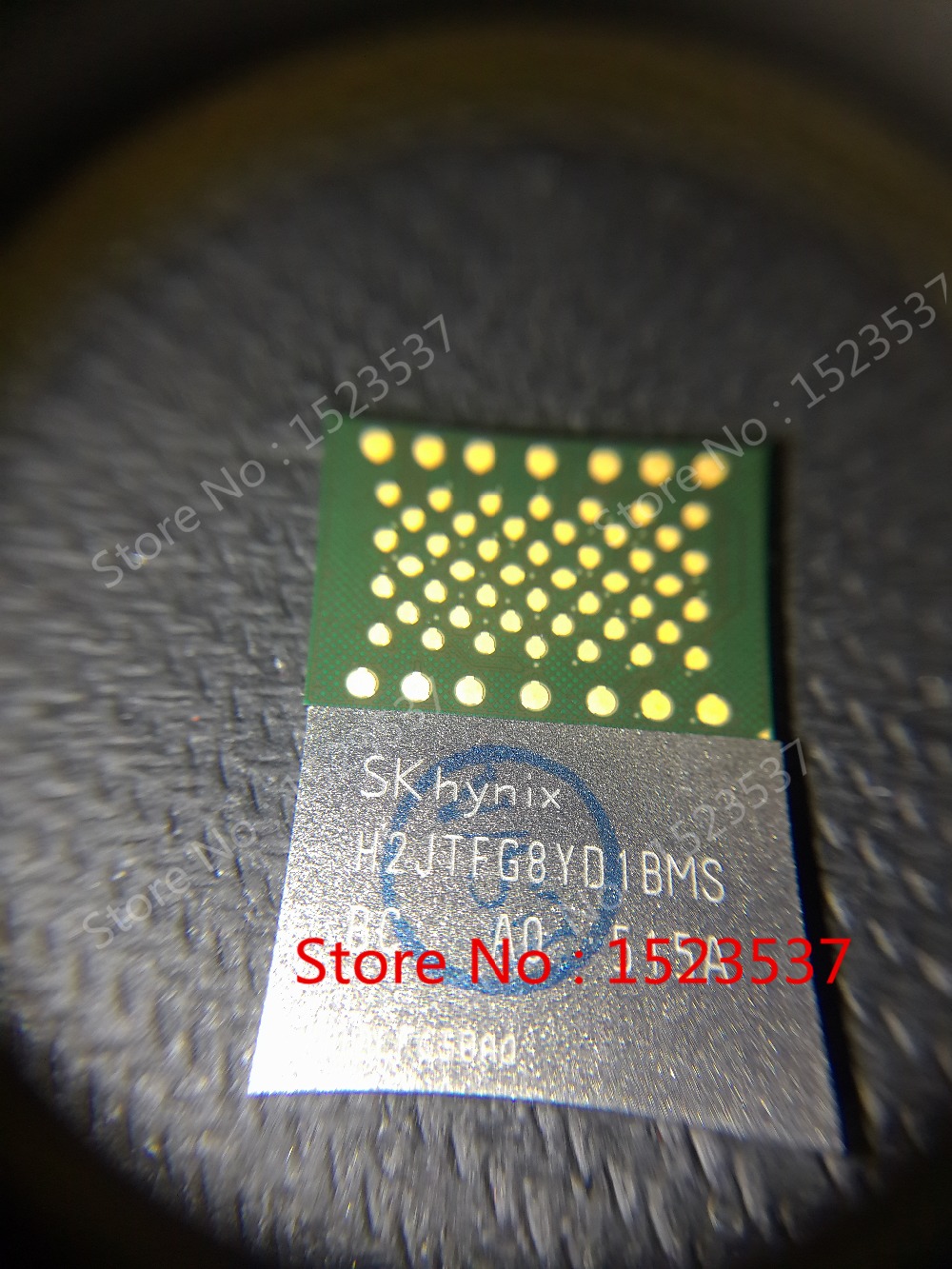

I have a NAND chip from a SKhynix,
H2JTFG8YD1BMS
BC A0 441A
Photo attached.
Which adapter to use?
TLGA-52?
Thanks.
Phil

Hello!
This is TLGA-60 - it has 8 addition pins in central raw. You can try to read it with TLGA-52, but there might be issues.

Hello Oldman,
I have the same problem,
I need to read the Nand chip H2JTFG8YD3MBR, this is too TLGA-60.
Could you to read the chip with apdapter TLGA-52?
Thank and regards.
Re: Which adapter to use, TLGA-52?
Postby Roman_TS » 13.03.18, 11:13
For reading BGA-60 with TLGA-52 adapter, you have to chose reading scheme number 1785, and ignore all others during chip reading. It will help.

I have never had success reading in TLGA-52 reader, but I only see this a small number of times so is not a problem to wire manually for reading

Sorry for the delay as it is such old post, seem that I was not able to read and recover it successfully. :cry:
