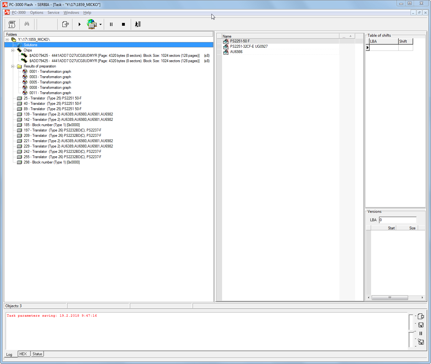

AJ2008 I have here:
Data Inspection - complex analysis.png (34.38 KiB) Viewed 19487 times
My version is a little older...
I did not try RAW, I wrote a ticket on Romanov's proposal, so I'll see.
AJ2008 certainly thanks a lot for the effort. I'll let you know how it all went.
