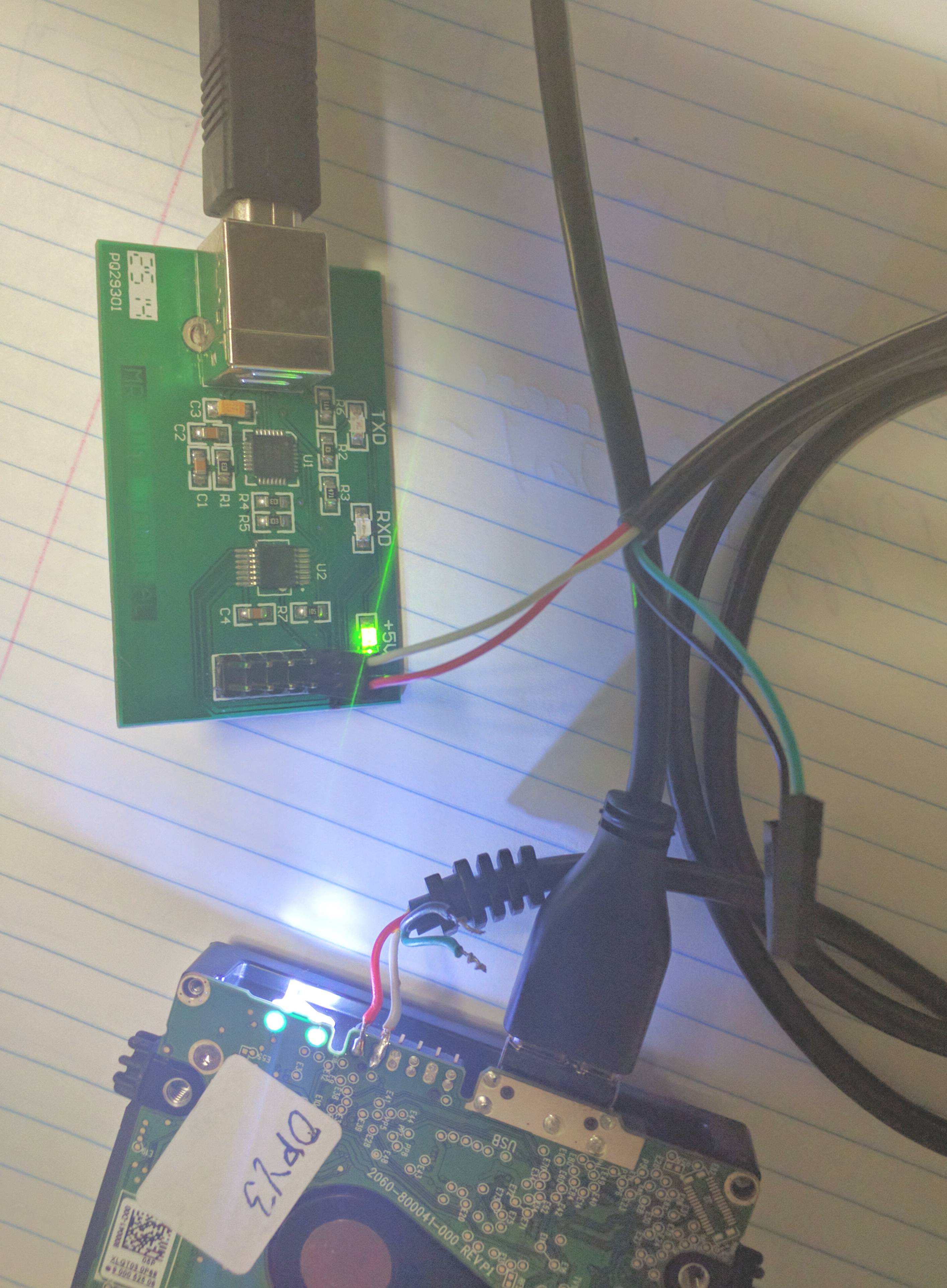

how to make com port connection to
800041 board
800022 board
skype: wayne_horner

drdoc wrote:Source of the post how to make com port connection to
800041 board
800022 board
Wayne ,
No ground necessary ?
Re: How to make a com-port connection with WD USB drive
Postby DataMedics » 20.02.17, 22:07
I think a ground connection is pretty much always optional with WD. I never bother.
Postby Amarbir[CDR-Labs] » 21.02.17, 06:26
DataMedics wrote:Source of the post I think a ground connection is pretty much always optional with WD. I never bother.
Jared ,
I think its working cos usb ground might be in use :D
Postby DataMedics » 22.02.17, 20:23
Exactly. And even with the SATA boards, I never bother with a ground and it works too. Probably because it's getting the ground from the SATA power cable.
