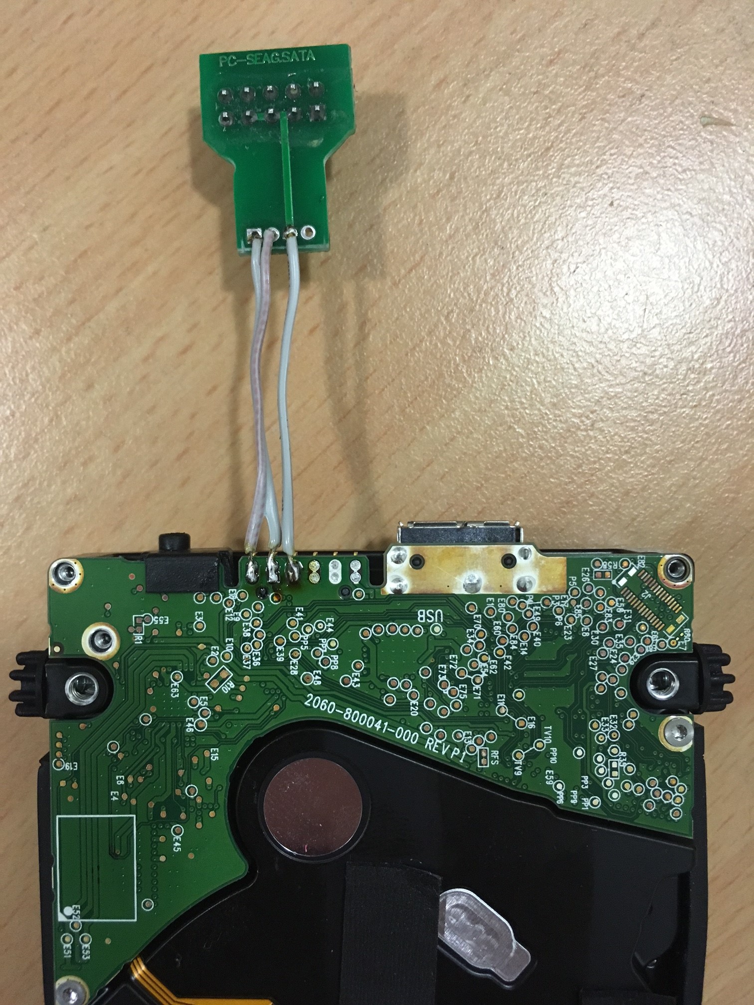

I'm about to order these new adapters, but I can't tell from the photos exactly how they will connect. These new PCBs don't have "pins" coming out, but it looks like the new terminal adapter requires them.
What am I missing? How do you connect this Terminal adapter...
To this PCB?....

I noticed the picture of "to this PCB..." (in my previous post) was missing. Fixed now. Is connection to this new PCB possible?

300ddr wrote:Source of the post Is connection to this new PCB possible?
Yes, but you need to solder the wires from "USB HDD" pins in adapter to terminal pads
in USB PCB in the same order like if PCB has the pins and you connect it directly.
Expand view
Collapse view
It can be enough to use only three pins: white, blue and violet.

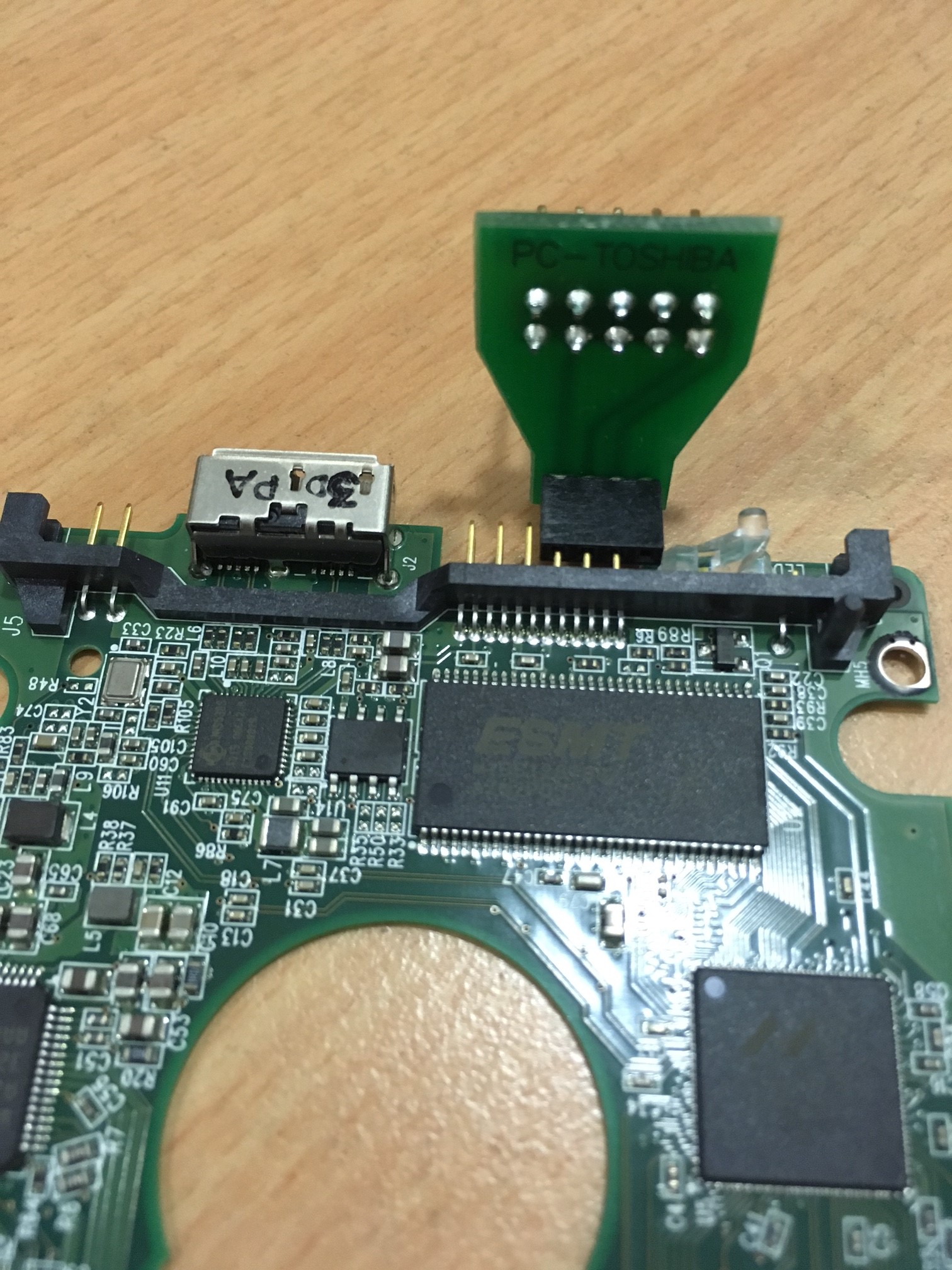

I read the ROM in boot mode on WD5000LMVW-11VEDS6 using Toshiba adapter, and connected it as a usb2.0.

All WD 2,5" USB drives (not slim)that has pins on PCB in two raws including this one from topic can be connected using Toshiba adapter as on attached picture
and this new L or as You wish J shape PCB can be connected via soldering 3 cable
