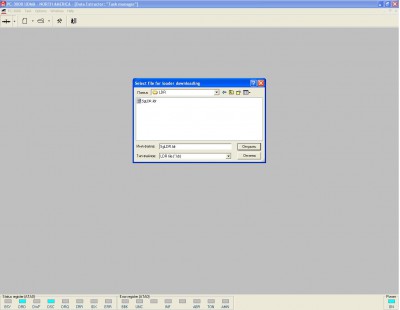

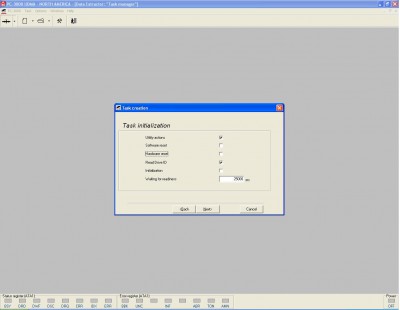

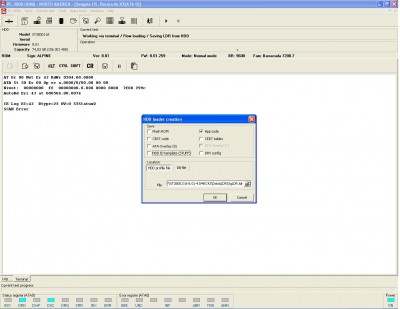

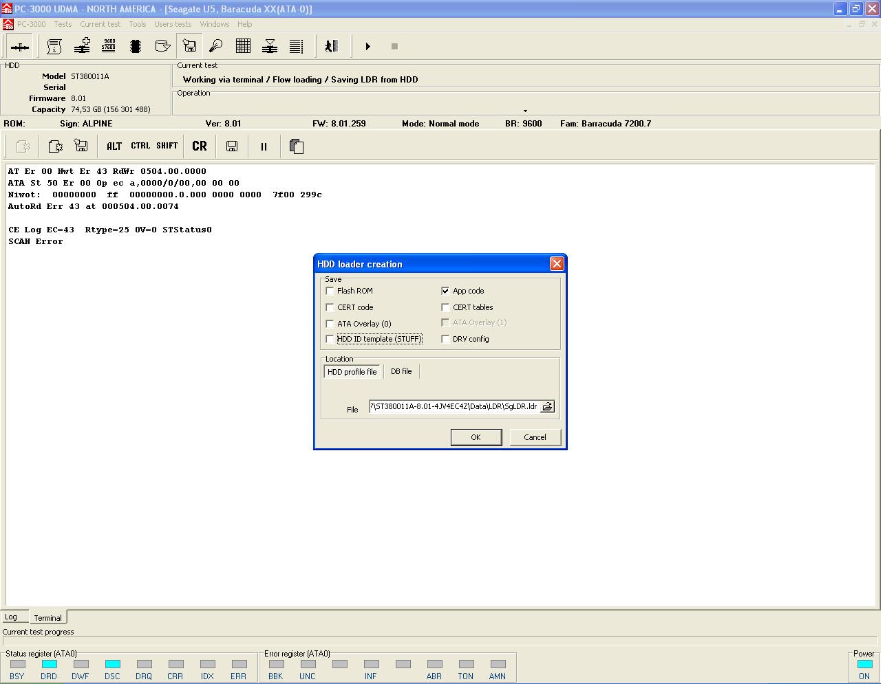

You should create loader with next options

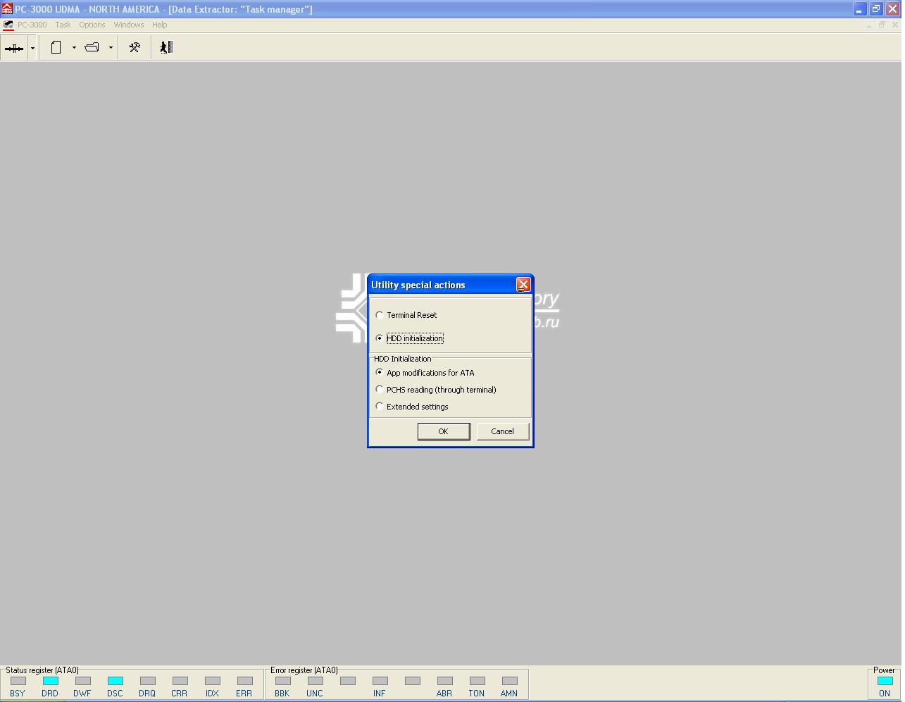

Then run DE with next options
Choose HDD initialization and APP modifications for ATA
Then select loader saved before
And try to make an image.
