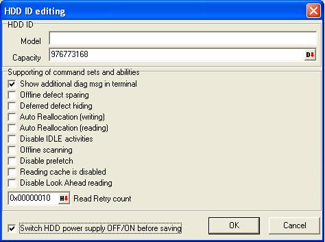

Try to perform next steps (you will need newest version of utility):
turn power on
immediately run utility
utility should be initialized properly
restart power again and immediately go to "Work with SA" - "HDD ID editing"
uncheck all checkboxes except first one "Show additional diag msg in terminal" and check "Switch HDD power supply OFF/ON before saving"
Press OK.
turn power on
Press OK.

Completed, I tried to attach the log as a .txt and .log and received the error The Extension ... is not allowed??
