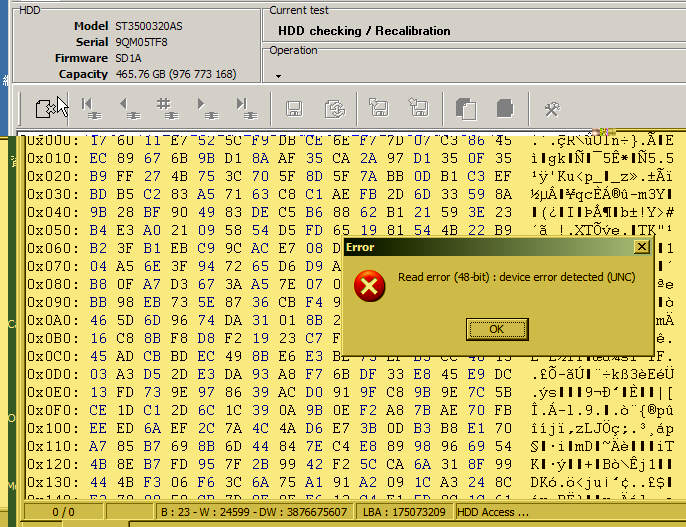

The track is unable to read 85%
500GB(976773168) only read to 170773168 sector
how can slave it ?

this is because u or somebody did a translator regeneration that did not run perfectly and the new user slip list is missing some sectors that the old one had.
Utility current version cannot handle it.
I can if U don't mind sending it.
pepe

first u have to check how many extra sectors are right before the point it gets unreadable, then add them to the user slip list.
pepe

My very first 7200.11 had this problem, so the standard solution the utility provides was only partial, I had to dig more deeply and develop some things to solve this problem.
pepe
