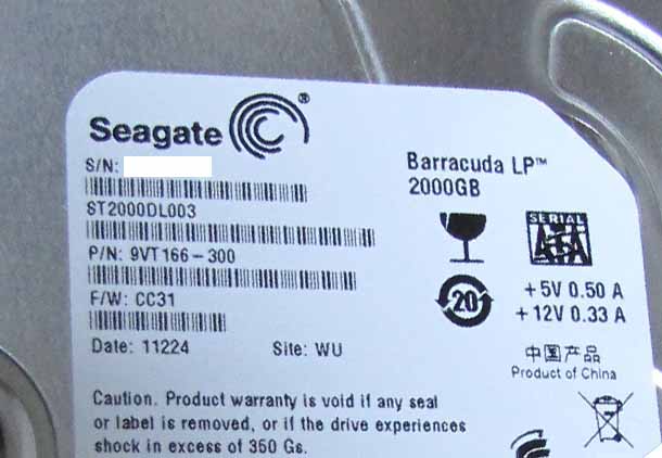

Is that the model? And what's the family?
Can you post a picture of the label?
Re: ST2000DL003 FIRMWARE PROBLEM
Please refer attached picture.
Now I see it. LP series.
Can you shows terminal log?

what is the problem with this drive?
