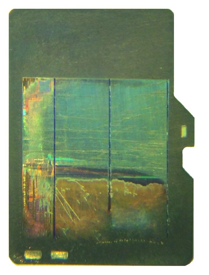

P.S. OFFTIPICK Here is a funny picture - I remove the compound layer from the front side of microsd, and get the crystal of NAND chip. Not sure, but looks like controller situated deeper in up side of the MicroSD :)

Laser decapsulation?
Re: Monolith and CPU influence
Postby Roman_TS » 17.03.16, 10:27
Marek wrote:Source of the post Laser decapsulation?
Rude force, sandpaper, fibreglass pen and 90 min of my time :)

Postby Marek » 17.03.16, 13:39
This is my :)
Laser: 445nm 1000mW - 30min
Laser 435nm 1000mW - 50min
Postby Roman_TS » 17.03.16, 14:09
Great pictures, Marek! :) Thank you!
