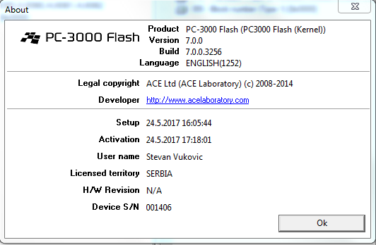

Data Inspection -> Complex analysis method - I did not even realize this is still available option - what version of software are you using?

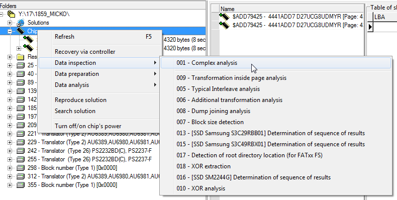

AJ2008 wrote:Data Inspection -> Complex analysis method - I did not even realize this is still available option - what version of software are you using?
Can you make RAW recovery against it to check if RAW files can be found? Maybe is no XOR present. how big is dump?
AJ2008 I have here:
Data Inspection - complex analysis.png (22.32 KiB) Viewed 20150 times
My version is a little older...
I did not try RAW, I wrote a ticket on Romanov's proposal, so I'll see.
AJ2008 certainly thanks a lot for the effort. I'll let you know how it all went.

I have 7.1.1 and I do not have this option for complex analysis, this is why I wondered what version you had (I have not had this option for such a long time I assumed it was totally removed)
