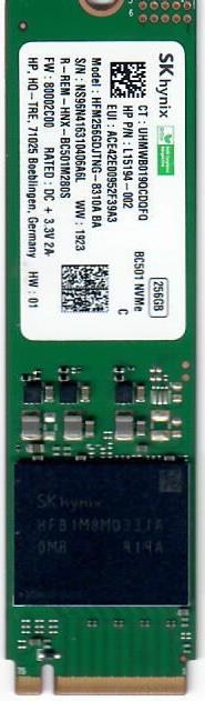

Hi Friends
SK hynix (HFM256GDJTNG) BC501 with HFB1M8M0331A controller. I can't find contacts to transfer to safe mode. If someone has encountered this ssd, please help.
Posts: 770
Reputation: 28 / (280)
Re: m2 SK hynix
Postby Roman_TS » 28.11.23, 13:32
SAFE MODE will block access to NAND chips array, so you would be able work with the drive RAM + CPU. Not sure how exactly it should help :)
Southman343
Posts: 2
Joined: 21.11.23
Re: m2 SK hynix
Postby Southman343 » 29.11.23, 05:25
The problem is that the loader does not load due to an error in transferring the drive to safe mode, but thanks for the advice
Posts: 770
Re: m2 SK hynix
Postby Roman_TS » 29.11.23, 08:13
But there is no Sk Hynix Utility in PC-3000 SSD, and no available loaders for this type of CPU.
It's a BGA-SSD drive, where controller, RAM and NAND chips are integrated into a common silicon layer.
