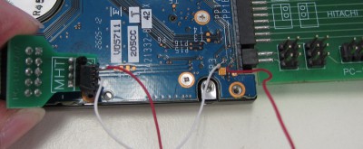

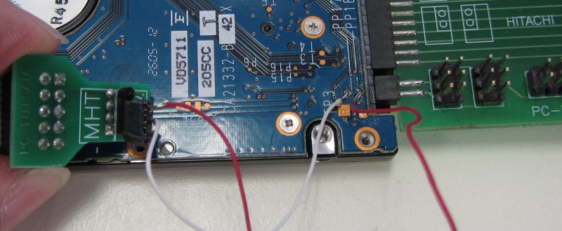

aviko
Joined: 12.09.07
Re: MHV2080AH Password
Postby aviko » 10.05.09, 20:49
If you havent adapter you can use seagate sata adapter and 2 goldpins. (TX and RX is enough). just look at pcb there are 4 holes for connector, put these goldpins there and look on seagate sata adapter where TX RX traces go. This is all you need. Tommorow ill take a picture for adapter placement.
Here it is
on this photo its MHW2160BJ
Who does not know anything, must believe in everything

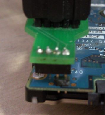

Postby avenger-fr » 10.08.12, 12:12
An other way (for MHV2100AH IDE)
25140 013_crop.jpg (104.03 KiB) Viewed 22607 times
