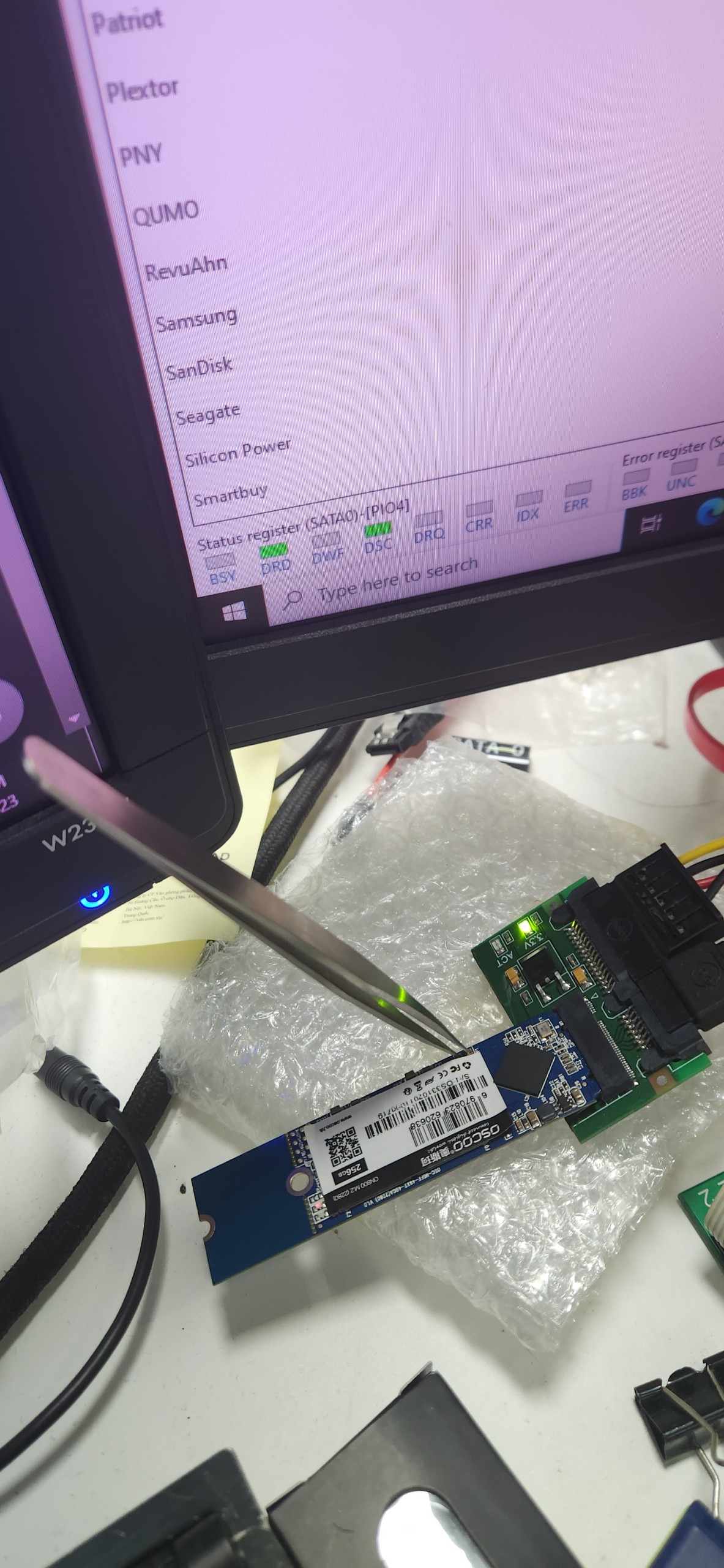

Hi i have an OSCOO M.2 SSD running SM2246AA Controller
It was busy upon turning it on
After putting into Safe Mode and Running Sandisk Utility
It showed the wrong SSD size with only 16GB capacity
Attention! The specified number of chips (16) does not correspond to the number of detected chips (8)!
Can anyone show me the way. Guide me through or have any thought about this problem???
Posts: 770
Reputation: 28 / (280)
Re: 256GB M.2 SSD OSCOO ON800 Showing wrong Capacity?
Postby Roman_TS » 17.08.23, 10:04
SM2246AA - is a controller microcode template, not a real controller name.
Please check the controller name on your PCB. It must be SM2246EN or SM2246XT.
Posts: 120
Postby gameboybin » 18.08.23, 03:02
Roman_TS wrote:Source of the post Hello,
It Is SM2246XT H AA Controller with Micron NAND chips
Posts: 770
Postby Roman_TS » 18.08.23, 10:22
Then use Sandisk Utility for SM2246XT. In case of any trouble - ask TS dpt, we will guide you.
