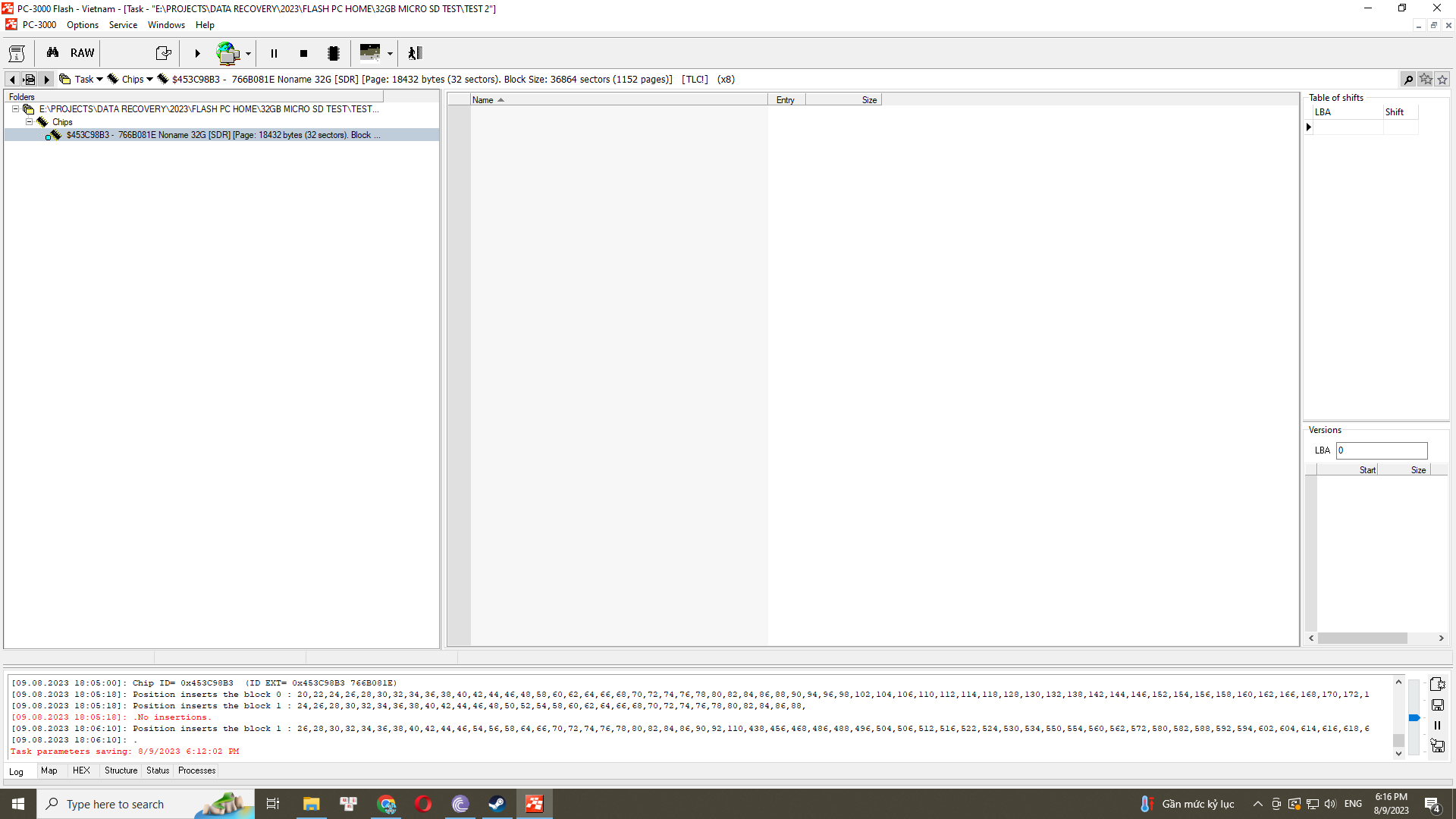

Can anyone help me identify this case
Working with George right now on this case. However everything looks strange
Used pinout Type 1
Got ID in green
Chip id:453c98b3
Upon looking at Page Designer. Most of the Bitmap is FFFF
Screenshot (230).png (107.81 KiB) Viewed 24347 times
Screenshot (225).png (11.23 KiB) Viewed 24347 times
Screenshot (223).png (21.83 KiB) Viewed 24347 times

Problem in this case is inside the power suply. You should reduce it to 2.45V instead of 3.3V. Otherwise, you will not be able to read it correctly - controller influence is broke the connection to the NAND array. With 2.3-2.6V (2.45 - most likely) it will read correctly.

http://odzyskiwanie-danych.com.pl/image ... arvika.jpg This case use LDPC + probably encryption. You can''t make it by chip-off method.
