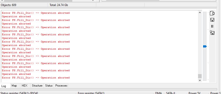

When saving saving files within data extractor on this particular job I'm getting continuous error messages. The repeated errors read:
Error FS.Fill_Dir() -> Operation aborted
Operation aborted
Any ides what causes this? Is it to do with length of file name or something? Unsure how this will affect the files yet. Ive only managed to save 3GB out of 1.4TB before this started.

Looks like the file system has some sort of corruption.
Hopefully someone from Ace can confirm.

It will likely eventually finish and get past those errors. But, you can also uncheck unnecessary system files that cause this.

turns out it was the length of usb cable the customer supplied on the destination drive causing issues, drive intermittently disconnecting. thanks for the responses.
