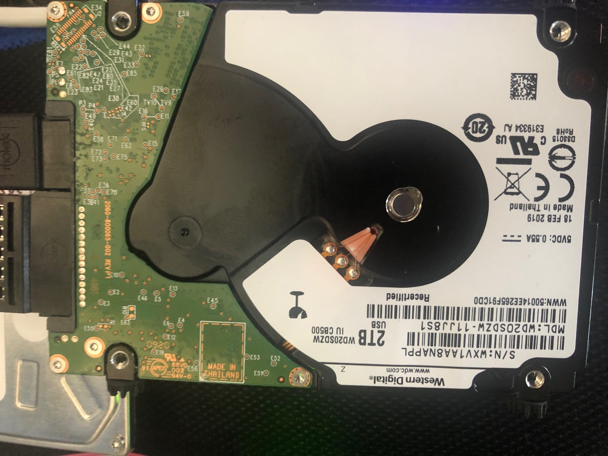

WD20SDZW-11JJ8S1 need 6008J F/w
Postby net2 » 15.07.21, 14:26
Hi :wave: ,
Please I need the Loader and DIR with f/w version - 6008J
Thank you :thumbup: .

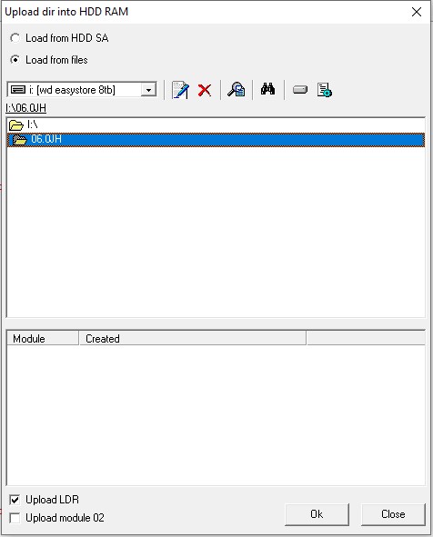

Hi, I have an open case with ACELAB and they wrote me this :roll: :
"Don't know what a files in this archive.
Requiers at least 11, 01 Sa modules, but of course better to get full SA backup." :shockable:
(I renamed with the .rpm and can open your files, but cannot load, or maybe what I am doing wrong?)
Thank you.
Captura de pantalla 2021-07-20 101620.jpg (35.21 KiB) Viewed 14123 times
Doomer
Posts: 135
Joined: 24.06.14
Reputation: 4 / (43)
Re: WD20SDZW-11JJ8S1 need 6008J F/w
Postby Doomer » 20.07.21, 17:34
you need to rename them as 1.rpm, 10.rpm, 11.rpm
Wow, if these people are tech support I don't know how they can help at all.

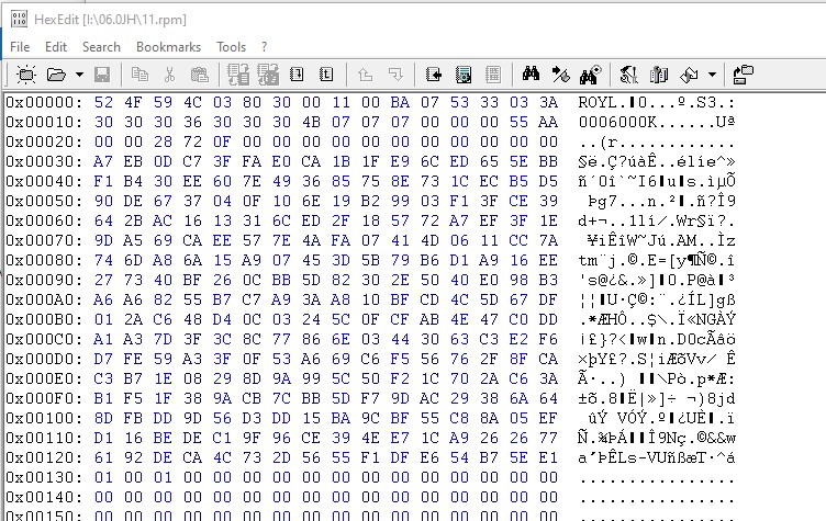

net2
Posts: 13
Joined: 17.11.19
Postby net2 » 20.07.21, 18:07
Doomer wrote:Source of the post you need to rename them as 1.rpm, 10.rpm, 11.rpm
Acelab checked the 11.rpm and said that is another firmware:
yours: 6000K
Requires: 6008J
But I want to thank you to take the time to answer the post Doomer :thumbup: , I will continue with the treasure search and as I get it I will upload the files.
Thks!

Filipp_TS wrote:Source of the post yes, we are tech support but there is no any sences to play charades with something abnormal names and files extensions.
Every one knows file extension of Sa modules = *.rpm
And requested f/w version is 6008J instead of 6000K
These are the files from ROM version 06.0JH, I have four SA backups of this version and all of them would have 6000K in the overlays (which is how it supposed to be).
There is no SA version in the world that would have 6008J in the overlays, because overlays on Charger drives always have +1 added in the header ie J transforms to K, 8 transforms to 9, E transforms to F etc. So to have "J" in the overlays would require "I" in the ROM revision and it just does not exist on Chargers.
Just don't rely on module 90 information, it is incorrect on Chargers sometimes.
Also, the 6008K overlay header would exist on either 06.8JD or 06.8JE neither on these is present on the WD20SDZW-11JJ8S1 model.
