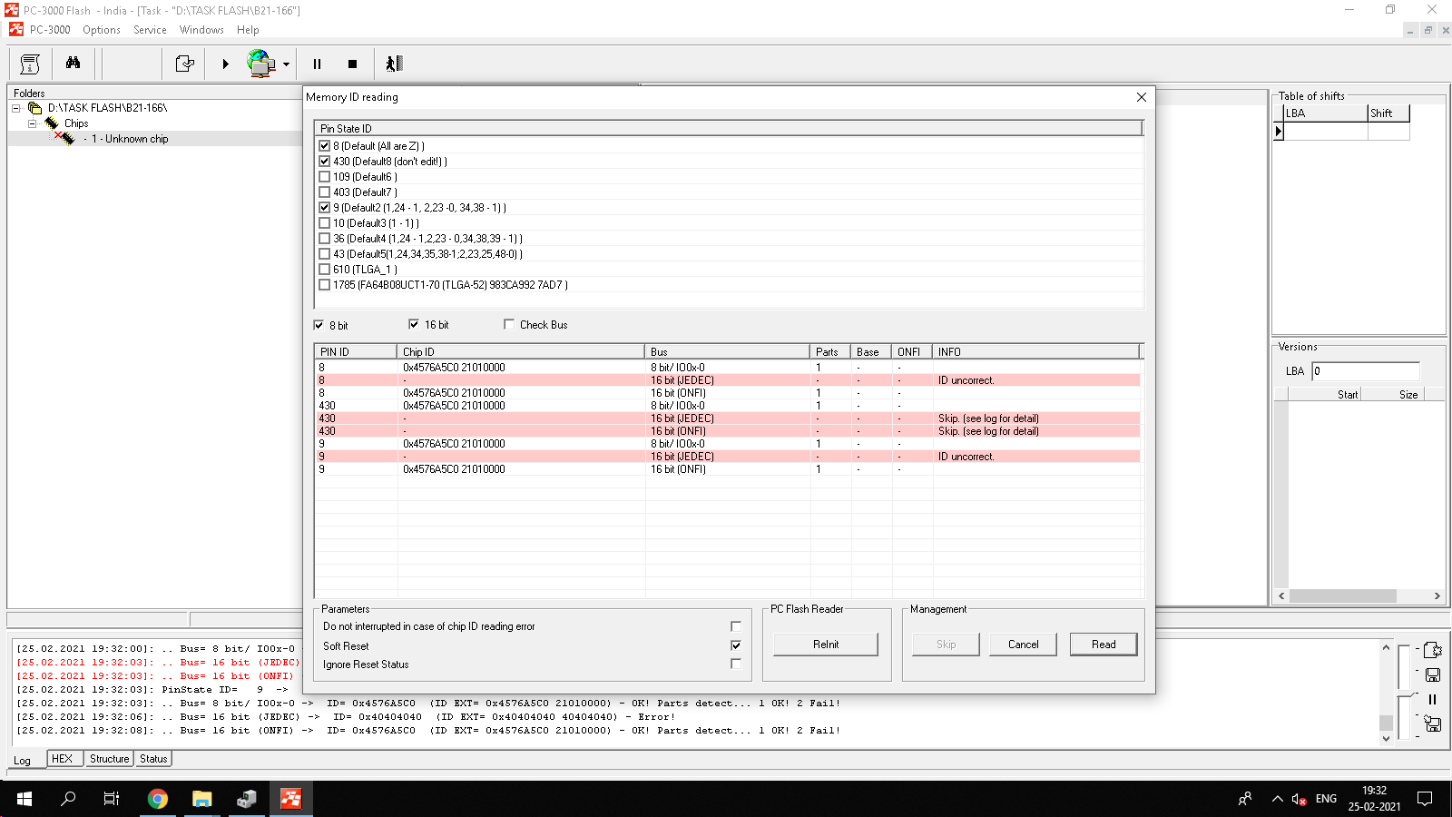

As I have found old 64 MB CF card not working so I have chip-off data chip but while reading chip id it is not reading properly as attached image is showing it reads partially.
Data Chip Id - S4044781 SDTNGAHE0-512 126901
Chip is very clean and I have made sure that all lags are fit perfectly still not getting results.
Thanks.
Reading Error.
B20-166 Read problem 8 bit read but not 16 bit.png (94.16 KiB) Viewed 141165 times

It's an old memory chip which was not in our database. But we can help you to add it into the software. Please make a ticket, and we will guide you.

UPDATE: chip is in database now :) Please update your resources in PC-3000 Flash and you will be able to read it.

Thanks for the update but after updating resource I still can not read the chip same problem is there. :shockable:
I might think I can not update the resources it is showing repeat download?

Did you reboot the program after the download?
It does not show unless you do.
I just uploaded the new resources and it does now appear in my database.

d_d_recovery is right. Need to restart PC-3000 Flash software after DB update (close all tasks and exit from software)
