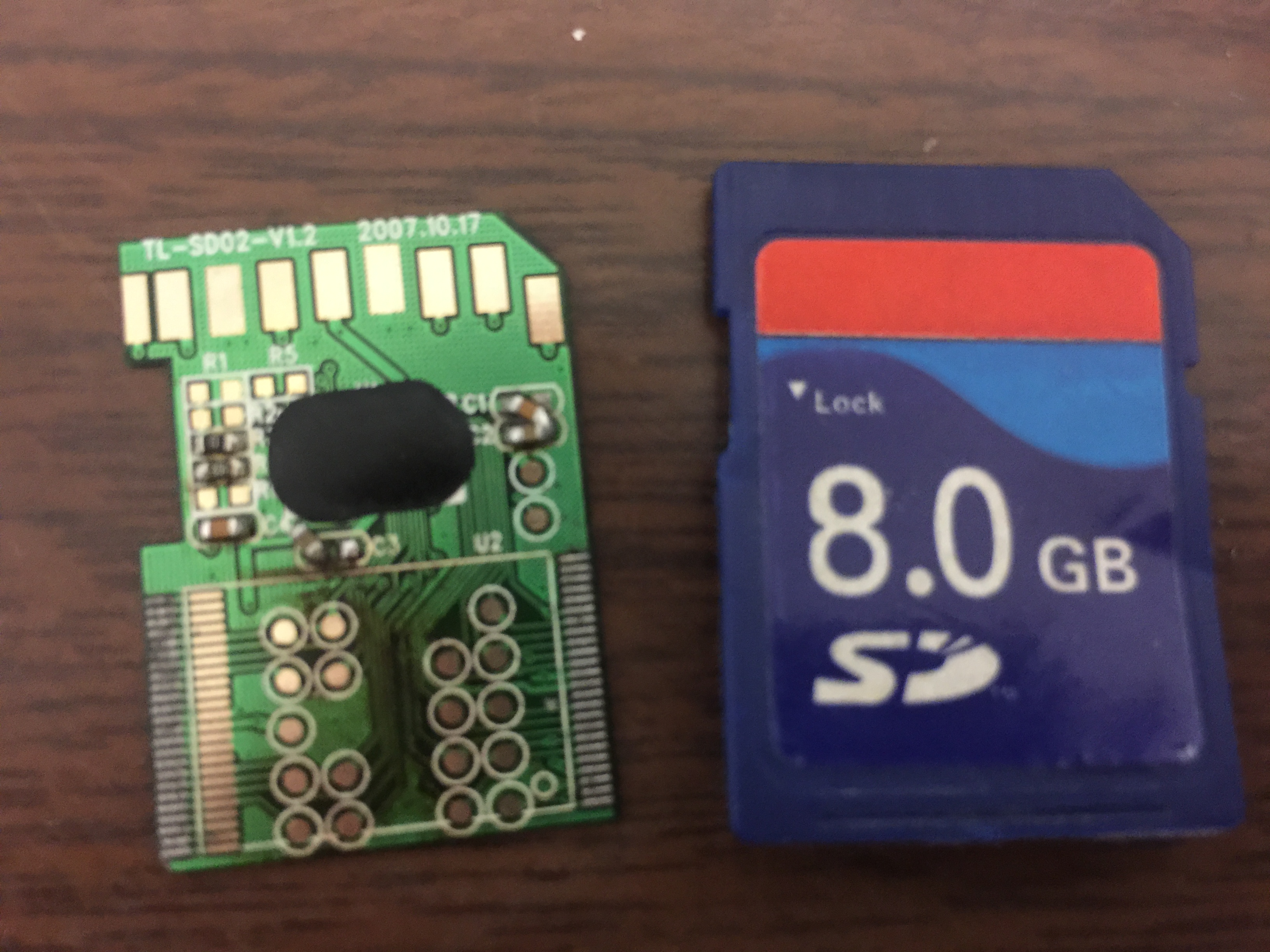

SD card is 8GB, but the memory HY27UV08BG5M is 4GB, only one chip,
PC3000 flash read out 2 CE, each 2GB
ID: AD D5 55 A5
No name for the controller.
Thanks.
Philip

oldman wrote:Source of the post SD card is 8GB, but the memory HY27UV08BG5M is 4GB, only one chip,
ID: AD D5 55 A5
Hello Philip. Please make a ticket in TS.acelab.eu.com, we will help you with recovery.

Case was recovered in ACELab ticket system. :thumbup:

It works, thank to Roman :thumbup: , great helped. :D :D
