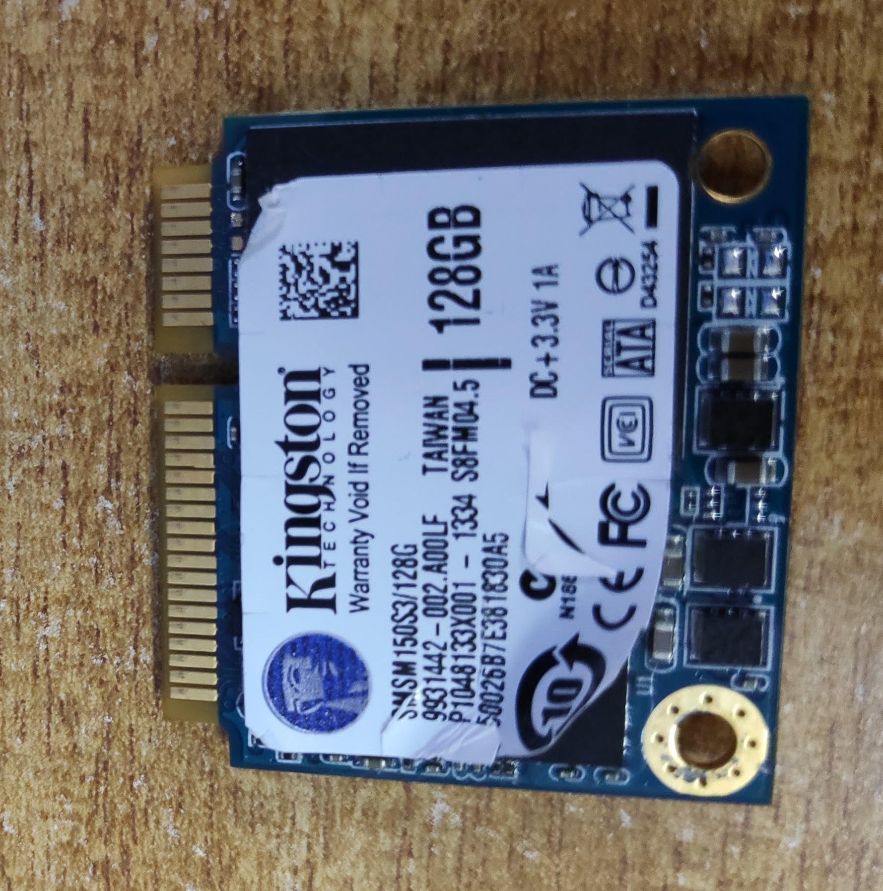

I have this SSD with PS3108.
When I try to create a translator witn FW loader 3.8, I get a message of L2P table missing.
With the other 2 loaders, I only get errors...
Any hints?? Loader not correct?

Loader is correct, the problem is in damaged or erased L2P tables which includes information for translator rebuilding. Most likely drive is seriously damaged in FW part. Without L2P recovery will be not possible.
