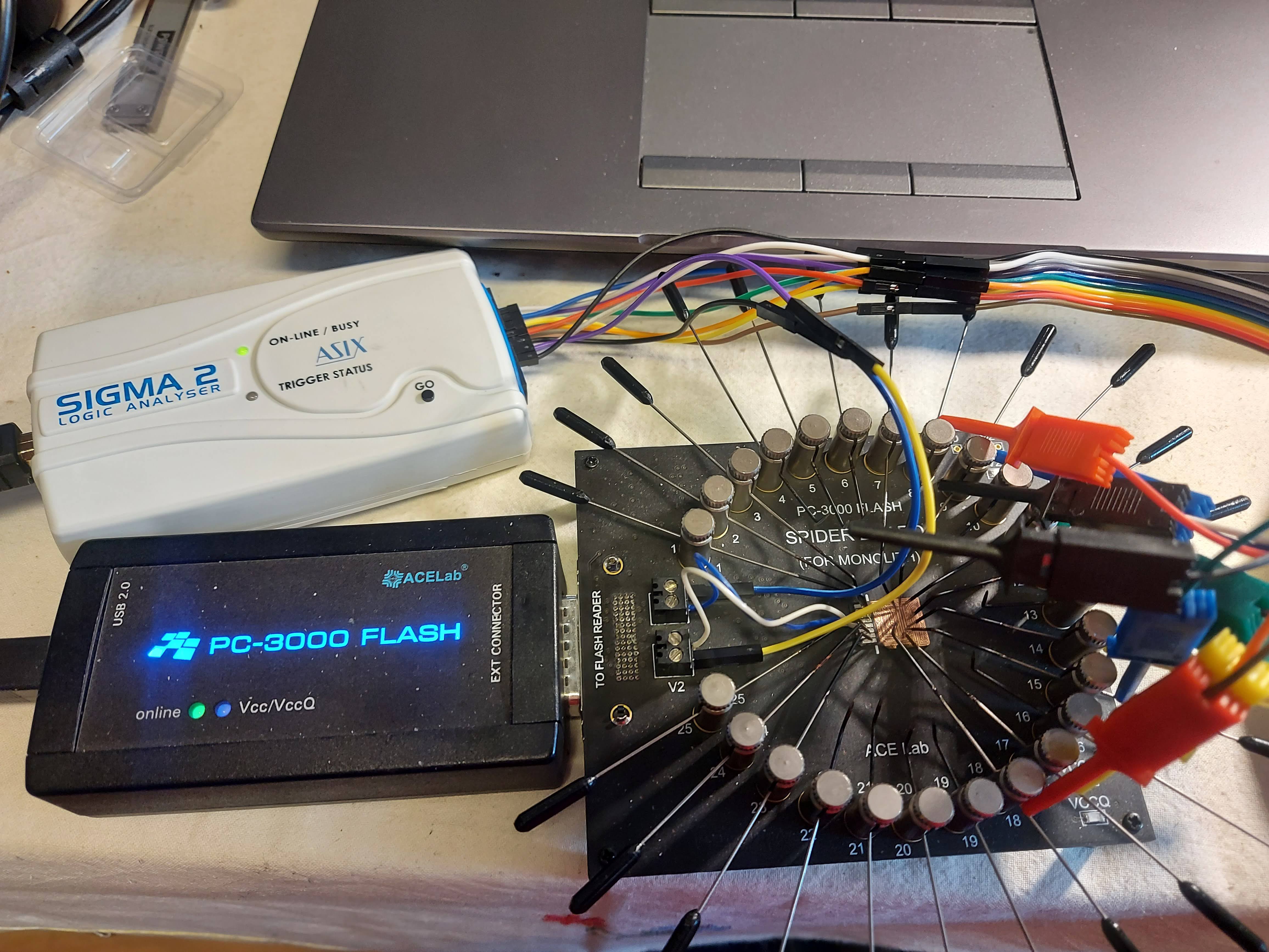

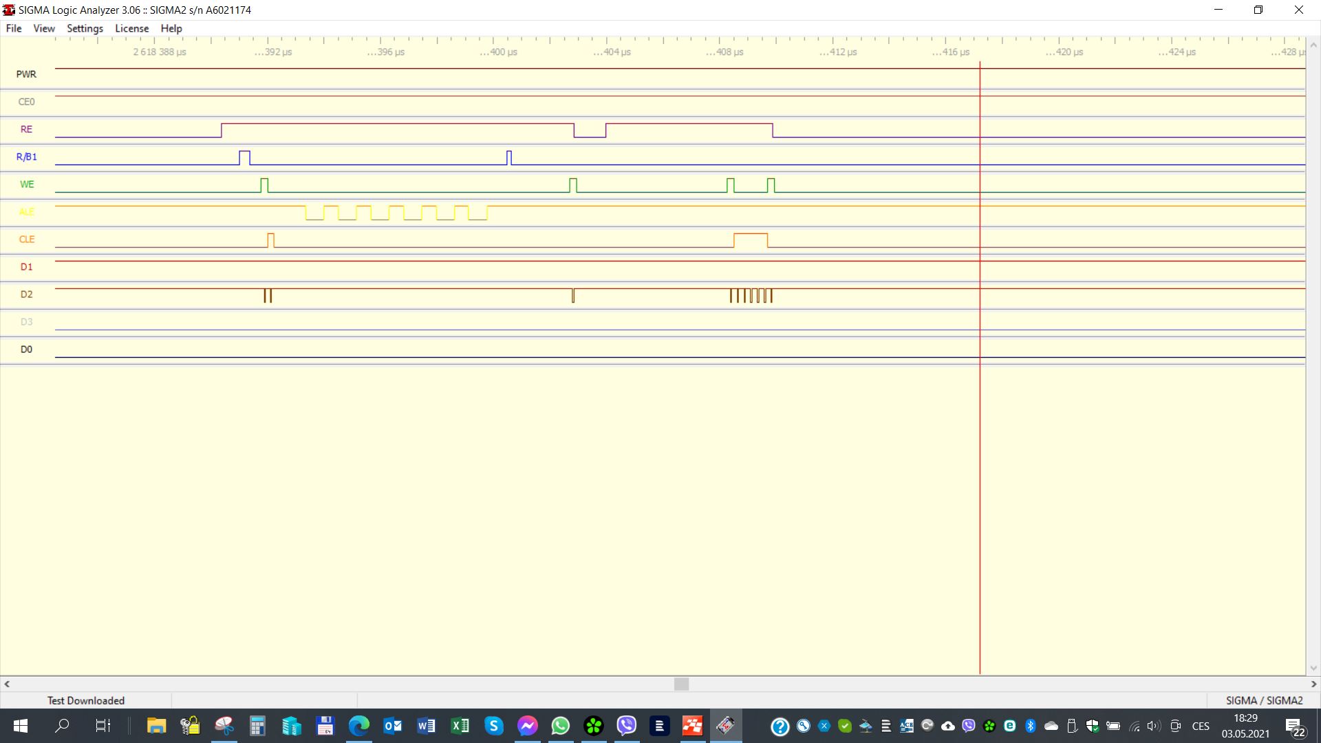

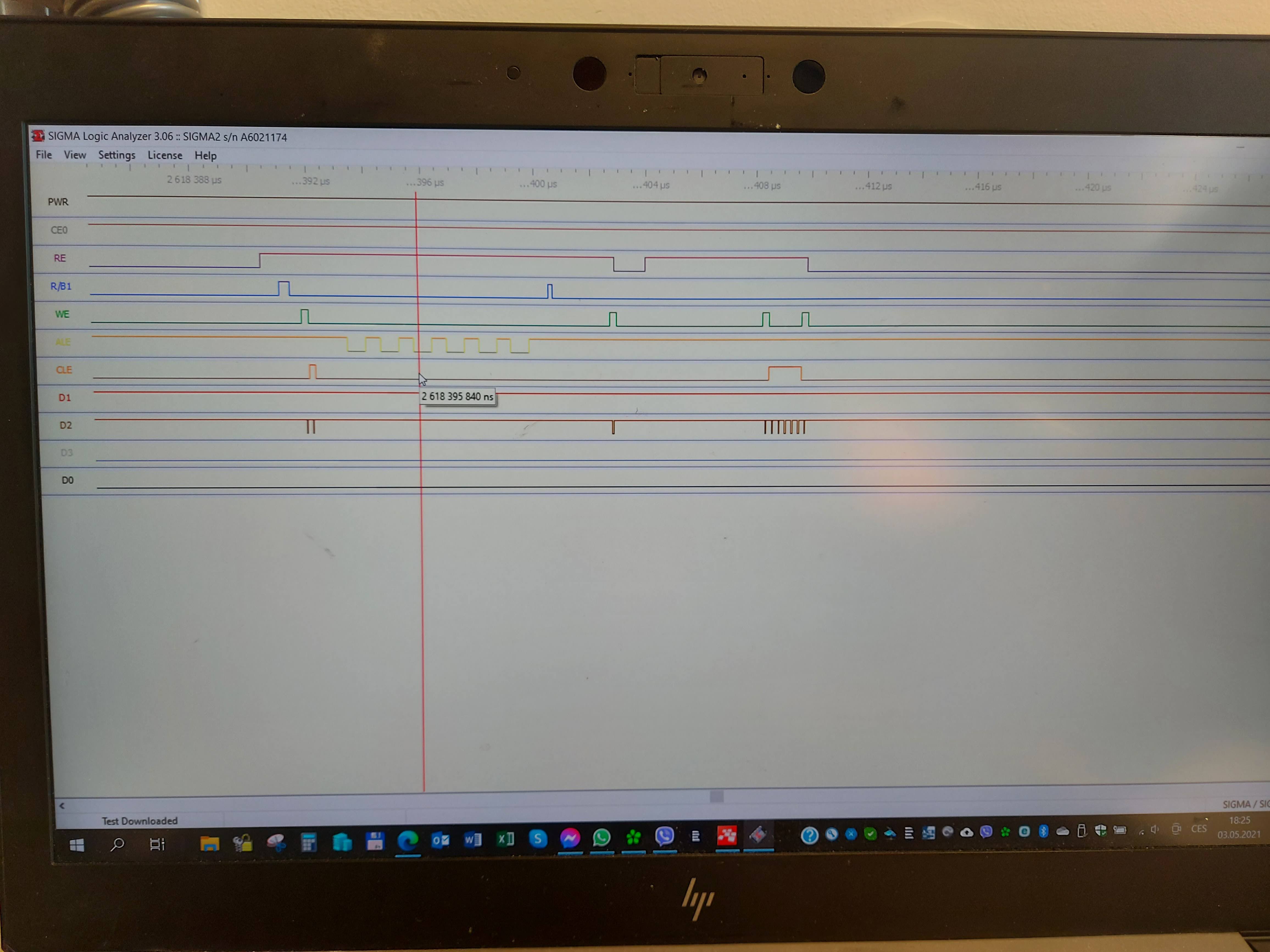

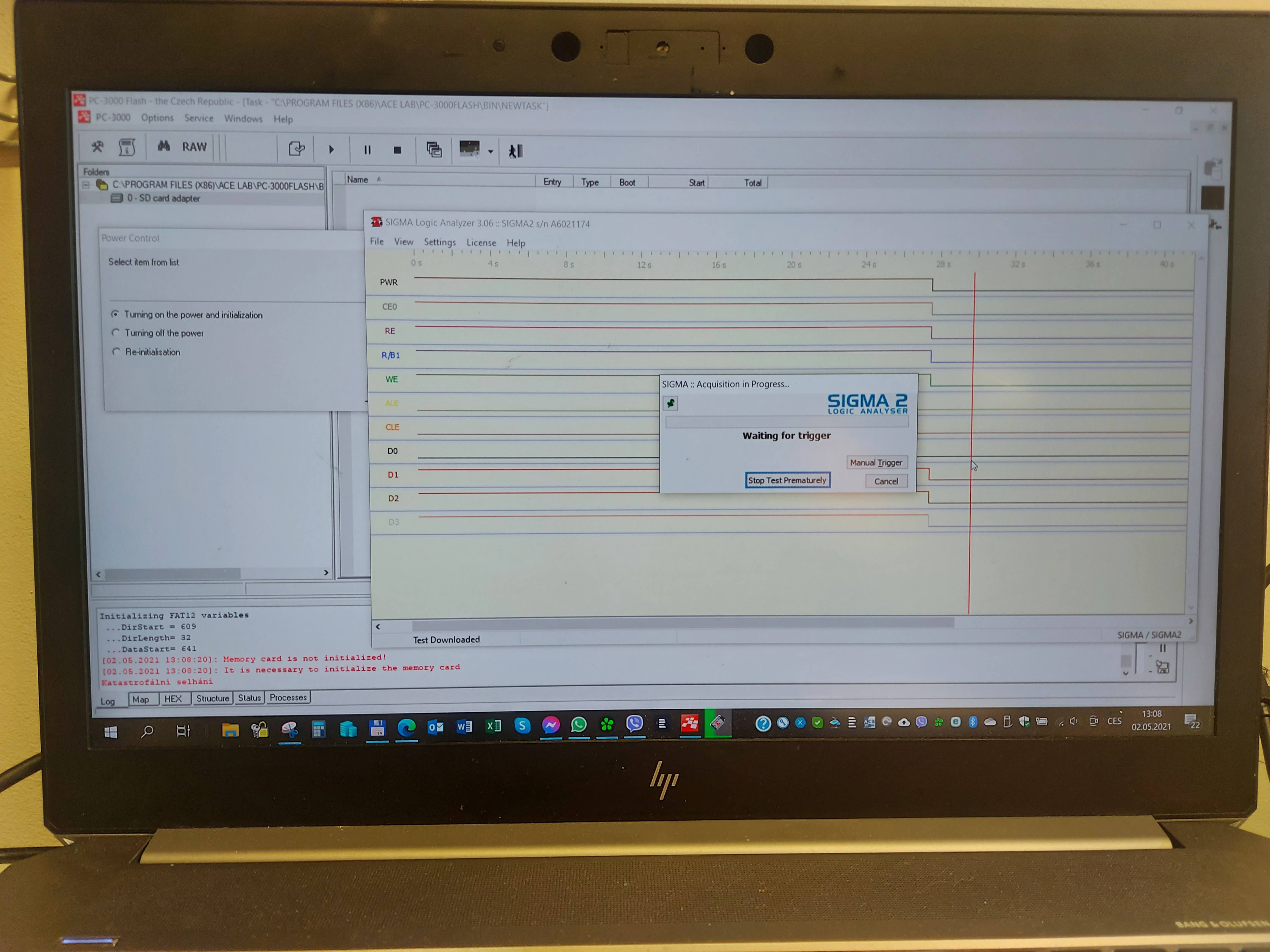

This weekend I have tried to find PINout of my card. :) I have borrowed logical analyzer SIGMA 2 from my friend, and played with it. It is not easy...
I do not know, if it good way... I use SpiderBoard and Card reader mode. Power PIN for triggering
