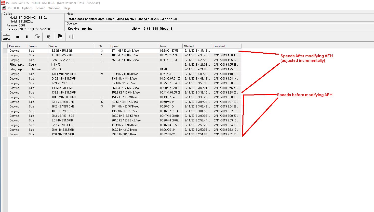

Okay, I can finally confirm that there is definitely some merit to this method. I had a Pharoah drive today that came in. Could get ID but would get instantly stuck busy. After modifying everything in firmware to stabilize it (disable reallocation,etc.) the drive would read but only at around 100-300kb/s max from either head. I boosted both heads by 20, head 0 started working fine and reading at 100Mb/s. Head 1 was still slow (reading around 1-2Mb/s max) until I boosted it by another 20 and now it's reading at around 60Mb/s. So a drive that definitely appeared to need replacement heads is now reading at a good speed and will be done in a couple hours.
It's not just a placebo effect, this definitely has merit. I can confirm that now.

Here's a picture showing the read speed difference when I made the AFH adjustments:
