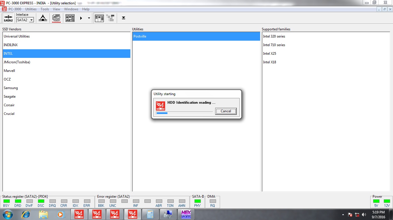

Hi All,
Intel SSD Pro 1500 Series 180GB comes ready mode (DRD And DSC Light on) After clicking the Utilities Showing BSY mode .
Thanks & Regard
Bikram Singh

Hello!
This is Intel SSD based on renamed SandForce CPU with modified Intel firmware. Unfortunately, there is no solution right now. You can read more here:
viewtopic.php?f=179&t=8701

any one have any solution this type cases we have Intel 2500 Series 180 GB SSD .
Bikram
Thanks & Regard
Bikram Singh
Re: Intel SSD Pro 1500 Series
Postby Roman_TS » 11.10.18, 09:21
The only supported Intel models are: X18, X25, 320, 510, 710 series.
