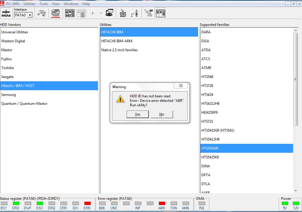

Hi guys,

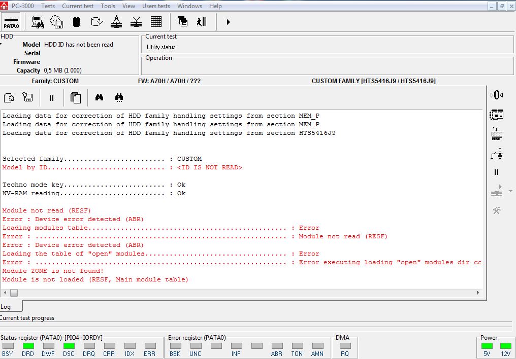

I have this drive that spin up fine with no clicking but after power ON I get ABRT error and after launch utility I get the errors in attached.
Thanks for any hint or help
Jojo
Load Utility.JPG (128.58 KiB) Viewed 10504 times

Nothing seems to be reading from platter ,I also see you have used the custom family which i think you have selected properly ,No module table is been read too,could this be heads ?

Amarbir[CDR-Labs] wrote:Source of the post Hi,
Yes Amarbir, about heads, I think so too.
I'll let you know
