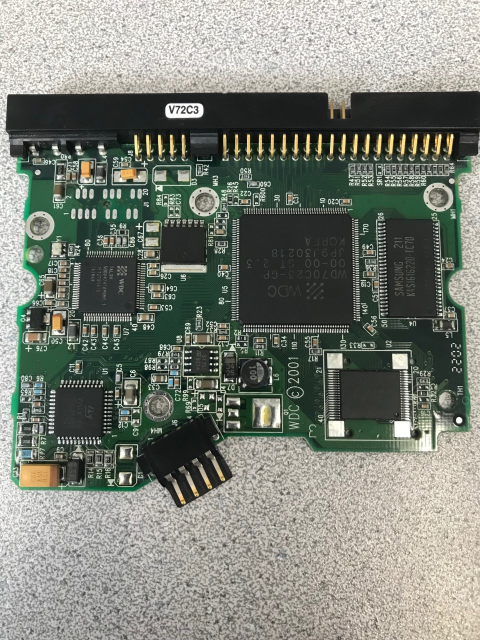

Picture of PCB attached. Im not sure if ROM needs to transferred on this one. If it is, I'm not sure which chip it is.
The only chip that looks correct is ST755 9224 chip but it comes up as something else on google.

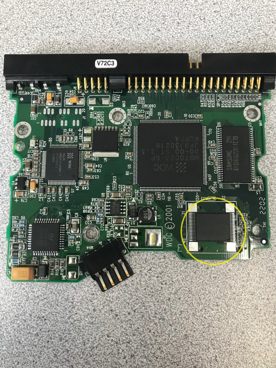

There's the M29F102BB chip circled in the photo.
It's coming up as 1 MBIT (64KB X16, BOOT BLOCK) SINGLE SUPPLY FLASH MEMORY.
But it seems ROM is not unique on this model.
