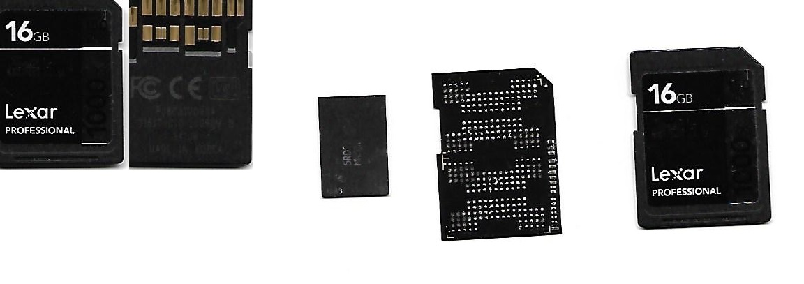

Hi all, can you help me with the controller for this SD card, 16GB SD, HCII, Professional 1000x Lexar
The chips are labeled 5RD22, NW552
I have tried SM2702 and SM2685 as was suggested for a 32GB Lexar, but it is not working - it must be something else.

I have included the scan with different parts of the card and a picture of the top of the chip. The 'PCB' is also included, as can be seen, the PCB housed 2 chips.
I have lost the back of the enclosure and I cannot find the numbers, the scan was done before I too the SD card apart and I have just added the rest of the pictures to it this morning.

2 like minded people learn better .anyway i can see its 2 BGA-152 type of nands in this ,But were is the controller is the controller attached on the opposite side of were the bga nands were connected ? . Or thats a monolith in itself ,now i also have the questions for you

Okay, this is what I think is the controller....

Controller here is SM2702, SM2703 or SM2685. Contact to ACELab TS and we will help you.

Case was based on SM2703 controller. Solved. Solution could be found here:
