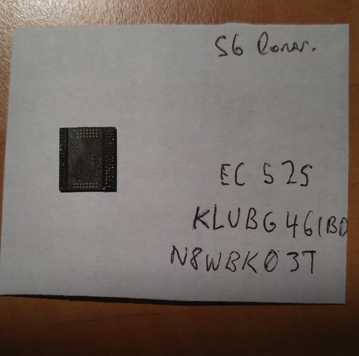

S6, S6 Edge, S7, S7 Edge and some new Xiaomi - all of them uses UFS (in this particular case it will be BGA 095) - not eMMC... only NuProg or FlashMax III support those chips

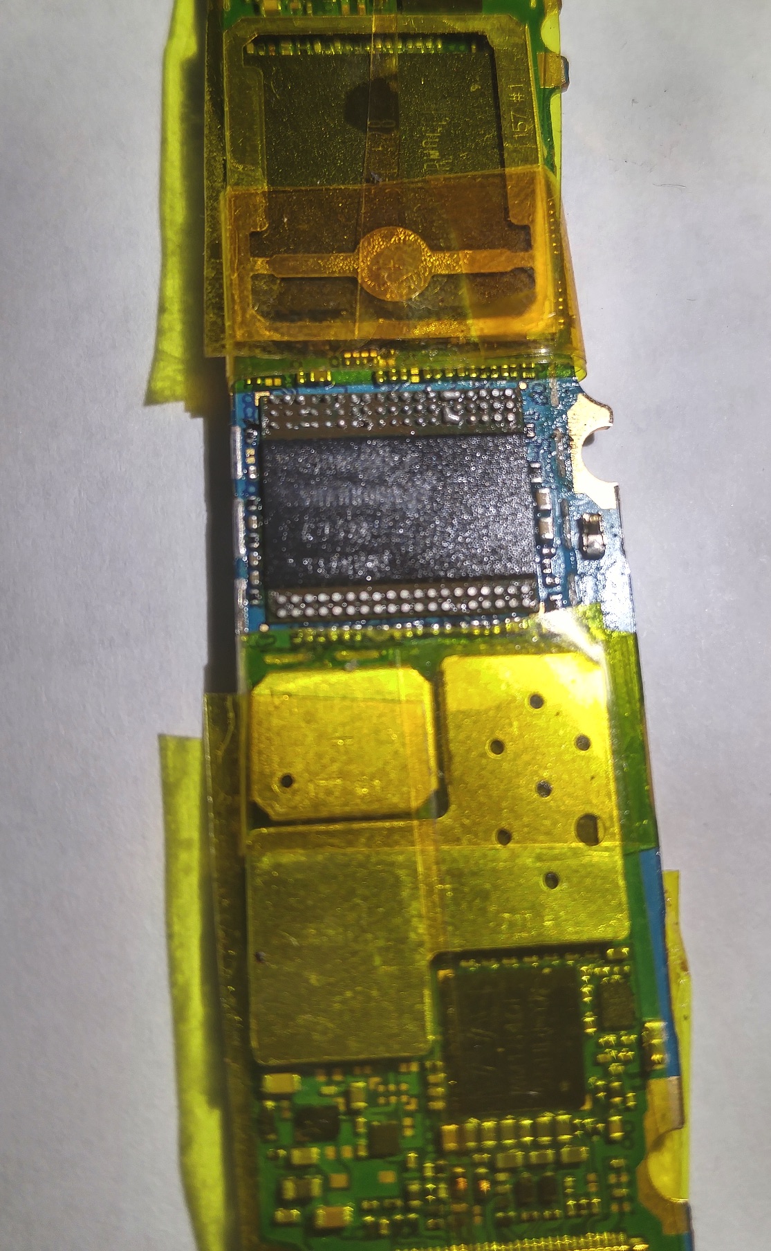

Got a Samsung S6 Edge and removed the memory chip. However, the chip had a different layout underneath than OP.
The layout matches the BGA095 Dediprog adapters
There was another chip underneath the NAND flash.
Markings:
SAMSUNG
SHANNON333
A1528
537KW08
Markings were hard to read, so they may be off by a bit.
Anyone know what this chip is?
A quick google search says it's a modem/baseband chip?

@- SHANNON333 is IC which got two dies inside- LTE Modem and DRAM..... it has nothing to do with DATA that you are looking for - answer for your question I give already in post up but I think you not see it
@antonvn: once again... this is NOT eMMC or eMCP chip - and pinout will not help you either in those
