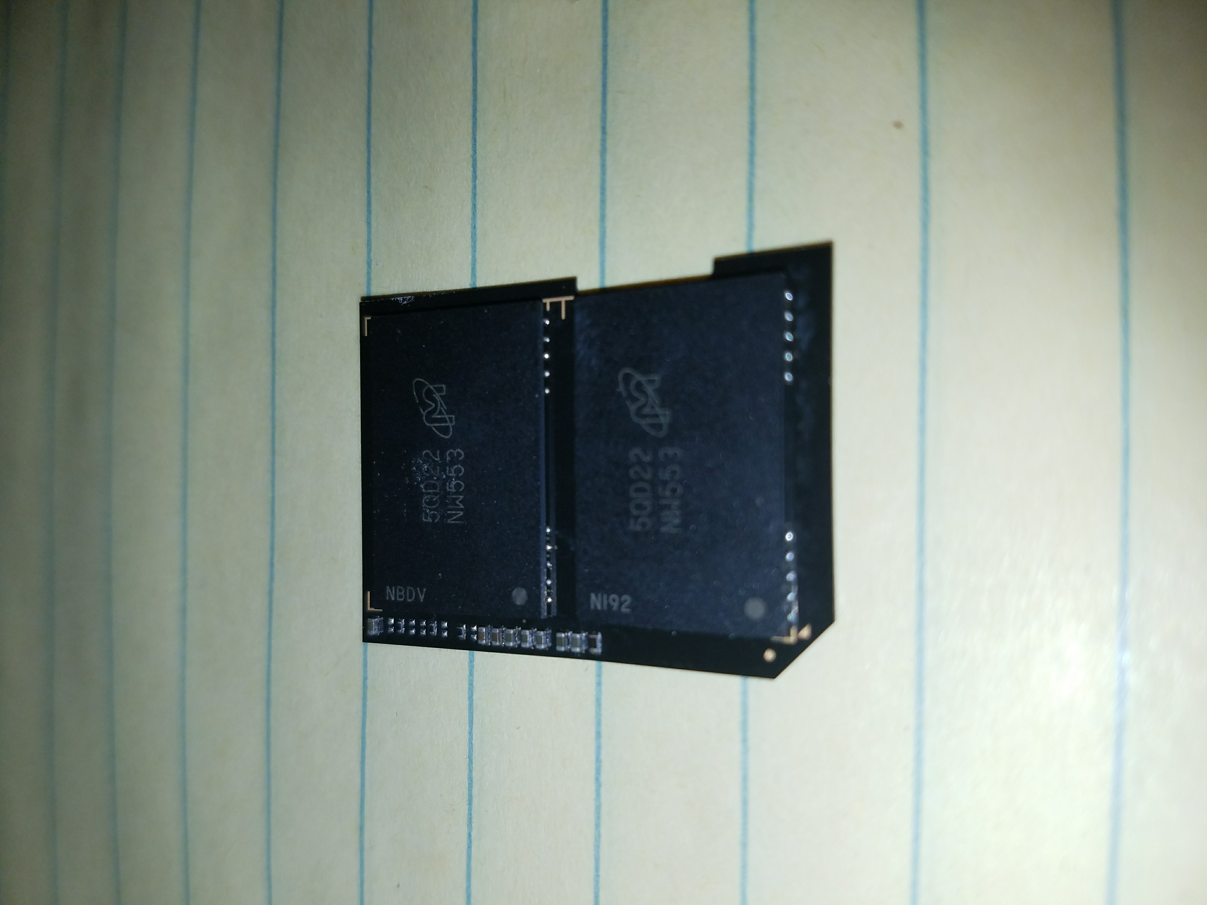

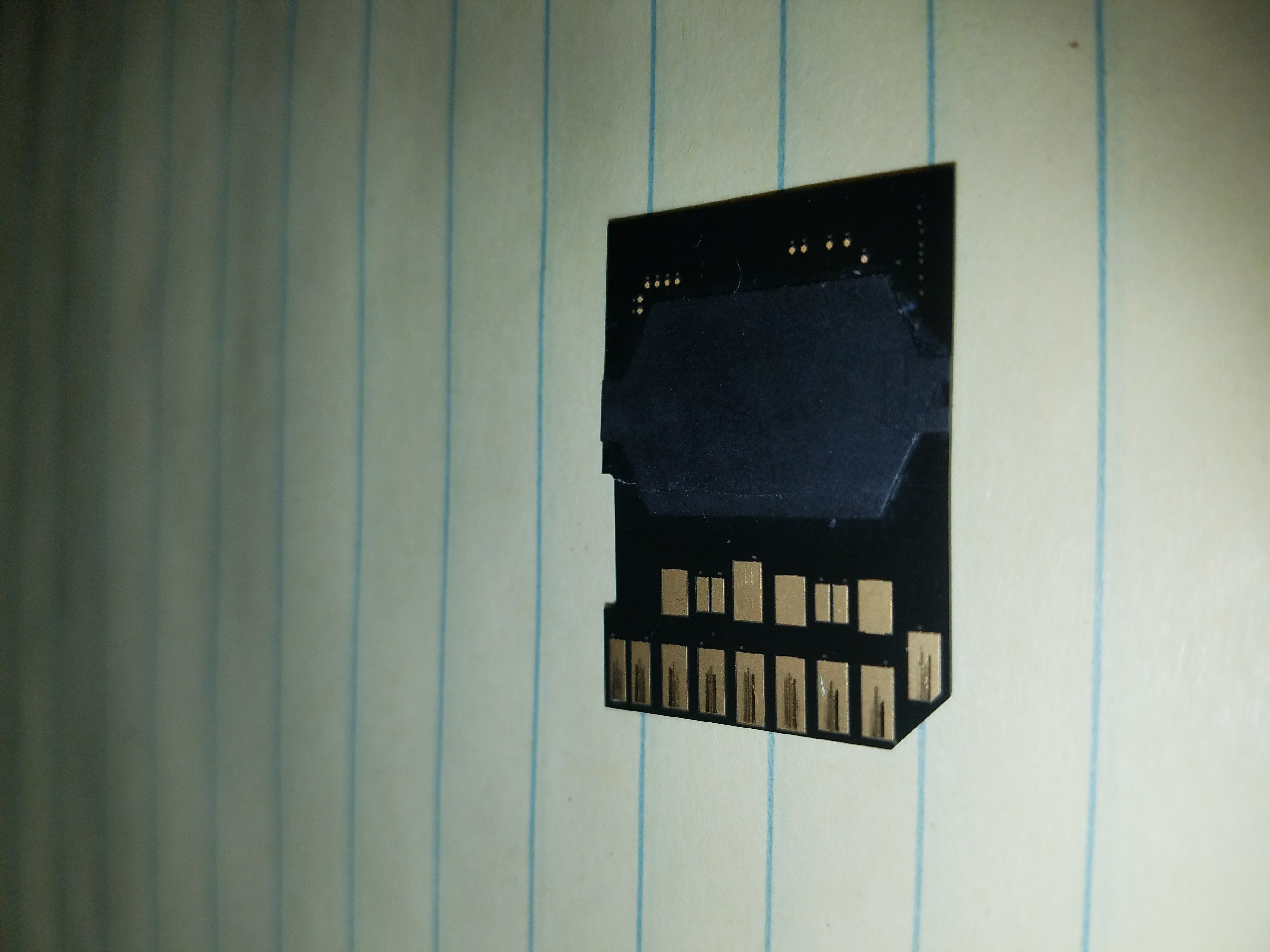

Postby obxspook » 28.02.17, 21:42
This is from the inside of a Lexar Pro Class 3 32GB SD card. Markings on the Memory Chips are "5QD22 NW553". There are no other markings on the internals.
Markings on the back of the SD card are
P38C2904C1
31531-C10-32GBBM
3185B
made in korea
Thanks!
Posts: 770
Reputation: 28 / (280)
Re: Need Help Identifying Controller type
Postby Roman_TS » 02.03.17, 14:52
Hello! Controller is hidden, but if it is Lexar - mostly probable it is SM2702 or SM2685.
Postby obxspook » 10.03.17, 06:04
Thank you Roman! I was able to get a full dump from the chips, and I found a workable solution from the global solutions center. 100% of the data recovered!

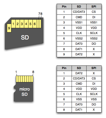

Where can I find the pinout from the micro Sd and SD card ?
Posts: 770
Postby Roman_TS » 01.08.17, 08:59
jerema wrote:Source of the post Hello Roman, thanks. I will try this.
Right here ;)
SD and microSD.png (58.5 KiB) Viewed 46557 times
Postby jerema » 01.08.17, 09:42
Thanks Roman, but in spider board I can only choice this:where is VSS ?
Bildschirmfoto 2017-07-31 um 15.47.39.png (16.64 KiB) Viewed 46555 times
Posts: 770
Postby Roman_TS » 01.08.17, 16:07
VDD = VCC = Power supply.
Anyway, We strongly recommend to solder PWR and GND wire to state interface, and do not set needles on POWER and GND. So, just set VDD to unused needle.
