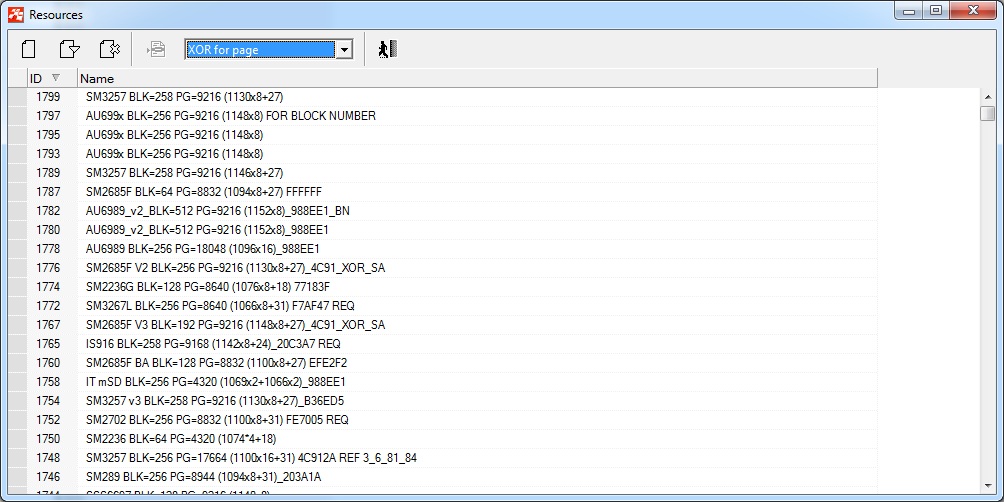

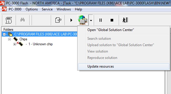

Starting from PC-3000 Flash 7.0.1 our developers add new XOR patterns in PC-3000 Flash database every week!
That's why it's very important to update your PC-3000 Flash Resources Database at least two times per week - it will help you to stay with the most actual number of XOR patterns!

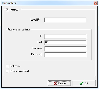

If for some reason, Update resources option is not available, make sure that:
1. Your PC is connected to Internet;
2. You clean "Local IP" field in OPTIONS - CONNECTION SETTINGS line;

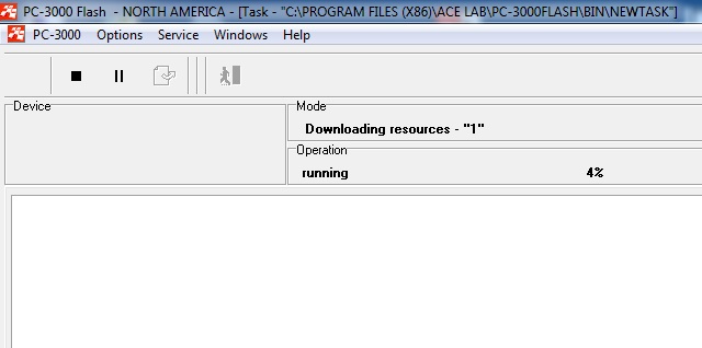

The pc3000flash tools ask "Repeat download". every time while opening a task.
Re: PC-3000 Flash Resources Update
Postby Roman_TS » 07.03.16, 17:02
Hello dear Hemendra. Please, follow to PC-3000 Flash task, OPTIONS - CONNECTION SETTINGS and remove checkbox from "GET NEWS" and "Check downloads".

Roman_TS wrote:Source of the post Hello dear Hemendra. Please, follow to PC-3000 Flash task, OPTIONS - CONNECTION SETTINGS and remove checkbox from "GET NEWS" and "Check downloads".
What Kind Of News Does The "Get News" Feature Do

Amarbir[CDR-Labs] wrote:Source of the post Hi,
It just allow you to see the news in html format in case if we decided to post some info separately from our official web side. For example - release features of the last version of software.
