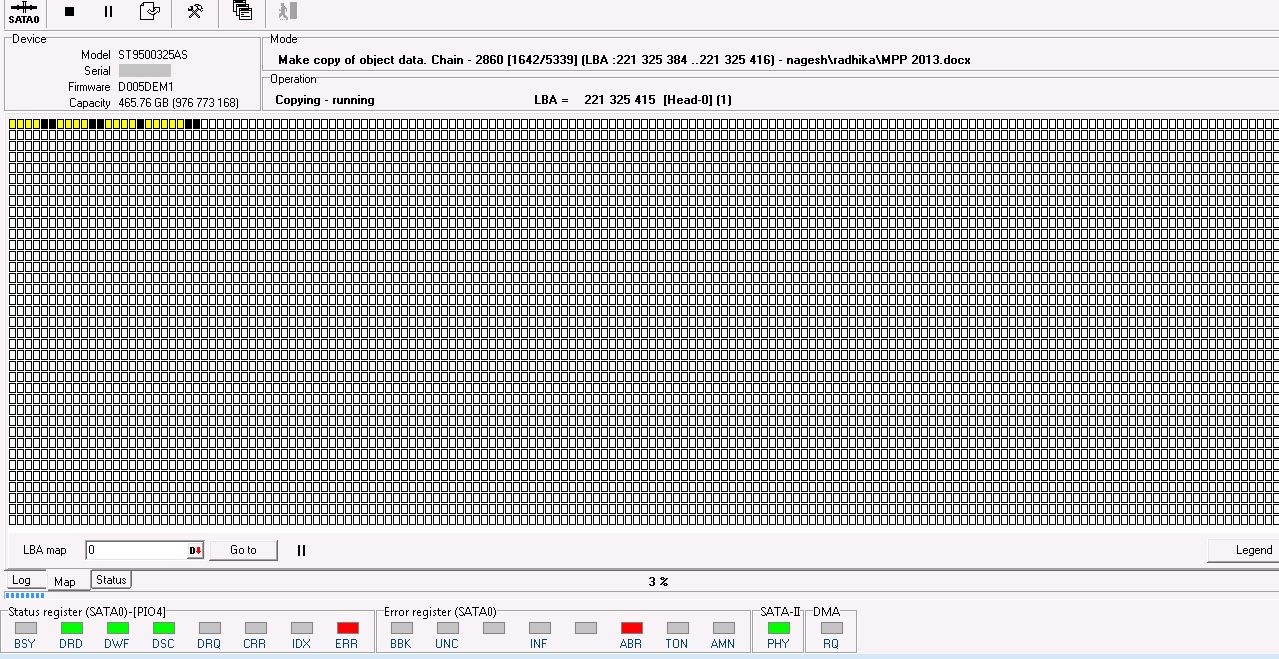

This hard disk ( attached snap) gives - SMART Bad +High Reallocated sector count in DOS smart test.
In udma express it gets detection and shows following Terminal. I could Image disk but suddenly it starts giving bad sector & only after restarting I could continue work again.
Since last sector is accessible I cant recover translator.
Can someone pls. suggest what I should do ? Thank you

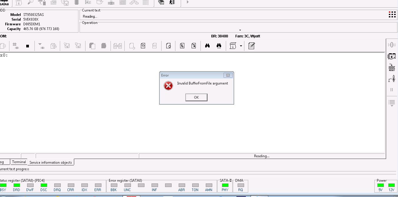

Re: Seagate ST9500325AS FW -D005DEM1 issue
As Jared suggested I tried to read system file 93 but getting error while opening & system files are not readable as well. . Also getting buffer related error.What should be by further course of action.
Terminal shows --
Send Status: COMRESET seen
Set Transfer Mode selected
Ultra DMA selected
Starting LBA of RW Request=0BDC3E78 Length=FFFFFFFF
ProcessRWError -Read- at LBA 0BDC4096 Sense Code=43110081
Unrecoverable Error Reported
(S) SATA Reset

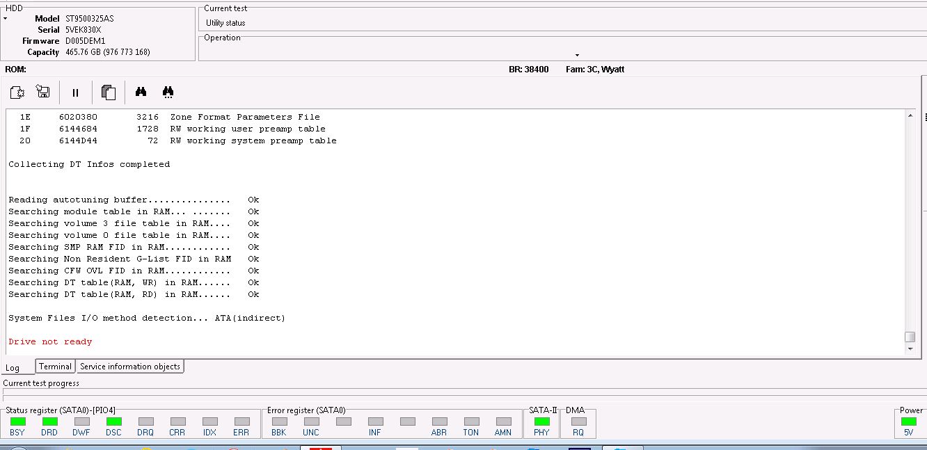

Thanks Filipp & Amarbir
Guys I can access System 8F ,but disk is reading slow with lots of defects. I must fix this issue as I think origin of bad sectors is in system files /SA
HI Good Morning.
This seems to be "7200.12 Sector Access Interruption " issue. So far I have reset smart and erased non resident G-list.
Since this is system file related issue , some technique must be used to identify why system files cant be read. I will have to read manuals so as to find solution for this issue,
