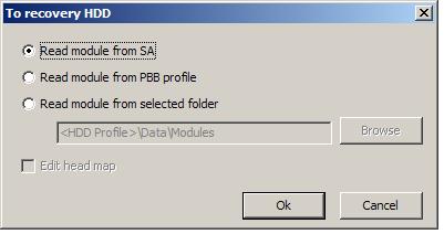

During autorecovery , Maxtor utility will attempt to save all SA modules to local folder.
At this step utility will query you about where you can take SA from.
1st option is will take the modules from drive itself
2nd option will take modules from HDD profile
3rd option let you choose the folder to take the modules from
