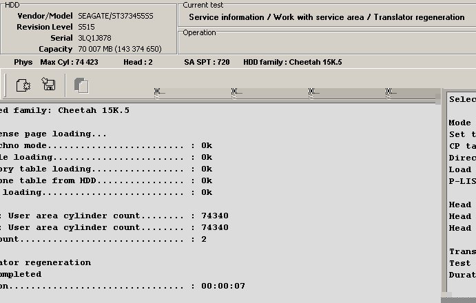

Re: Work with SAS HDD in PC-3000 for SCSI
Postby -BR- » 10.09.10, 01:22
Well, I was not able to test all Seagate SAS families yet, but all the ones which I came across, the utility was able to regenerate it's translator succesfully :P
Some recent examples of SAS succesfully regenerated translators:
Model: ST373455SS - Cheetah 15.5K family
Result: translator regeneration was performed succesfully
Model: ST3400755SS - Cheetah NS family
Follows attached a screenshot from Cheetah 15.5K command result
-BR-
Screenshot from SAS Cheetah 15.5K translator regeneration command resulting in success
SAS Cheetah 15.5 translator regeneration.jpg (62.55 KiB) Viewed 28260 times
Postby ACE_Admin » 22.04.11, 14:39
If there were a problem with regenerating translator, please provide hard drive firmware version. I suppose the problem is related to different versions.
