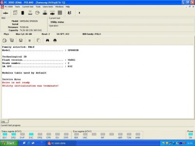

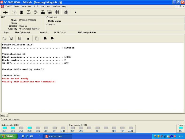

No, after they knock a few times, this drive doesn't into ready state (self). Just stop motor and still busy. However, when I run the utility with parameters "soft reset" disk run ready state (DRD & DCS). The motor stil not work, but the first detect is almost corect (corectly show model, FW and capacity - without sn.). After start further utylity hdd show (motor even durning try read SA still off):
