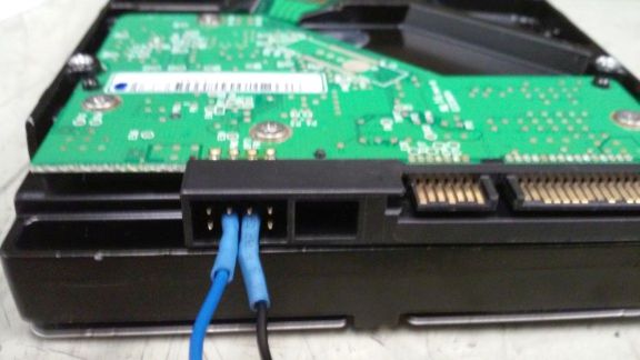

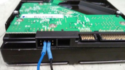

Here is the connection for 3.5" drives: blue to pin1 of USB Terminal connector; black to pin2
