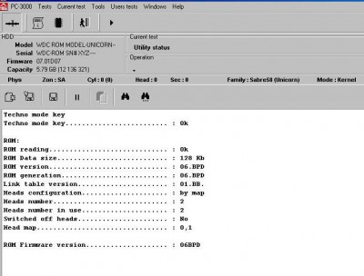

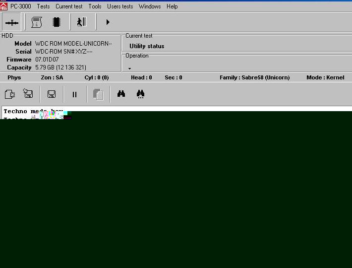

janos,
I have the same exact problem with a WD800JD-75LSA0. I understand that these wd have a screw on the top that holds the head arm in place and once you remove the top, the heads become unaligned. My question is how to you align this issues? I have a pc3000, ddi, etc....
This is what I get...
Service area:
SA dir reading (ID)..................... : Unknown error. Error code: 4343
Configuration reading................... : Module 02 not found
Thanks..
