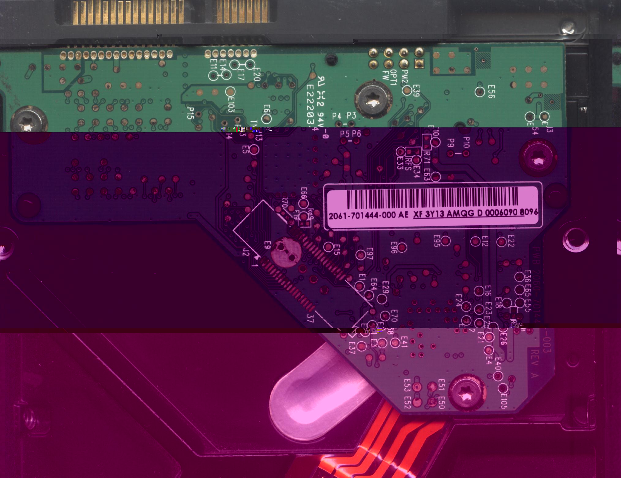

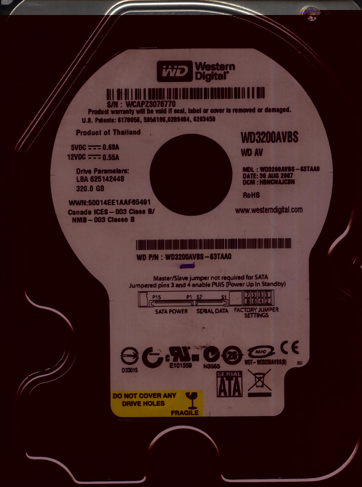

I have WD3200AVBS-63TAA0 the pcb no is 2061-701444-000
the PCB was burnt
I have the same PCB nimber 2061-701444 but my question is :
What is the Family of this drive?

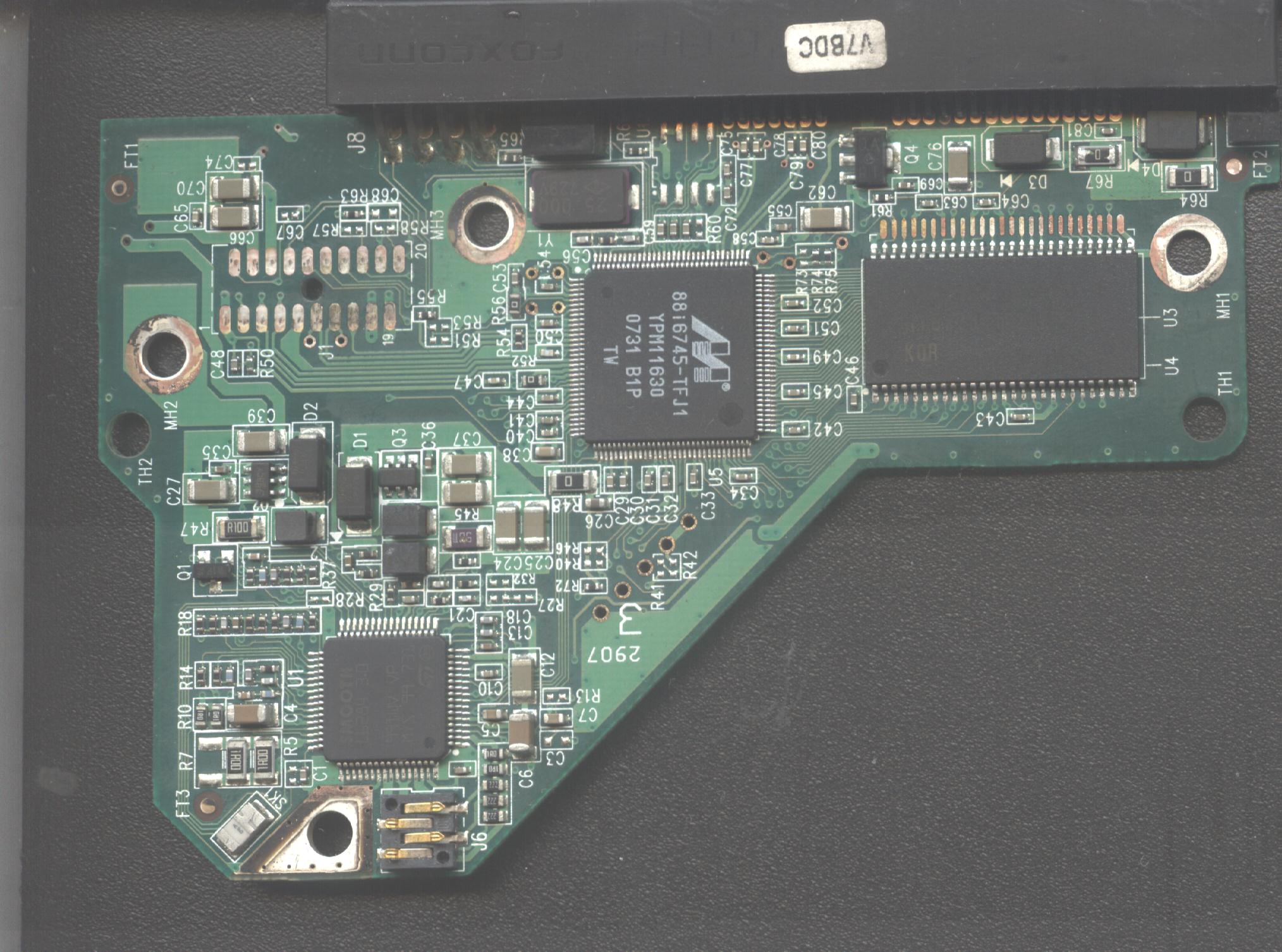

This model have no rom chip
the rom in the CPU chip and it was burnt

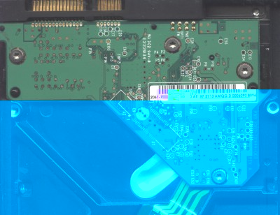

my best guess is Caviar
can u post the image of pcb other side
just to make sure
