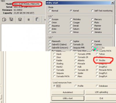

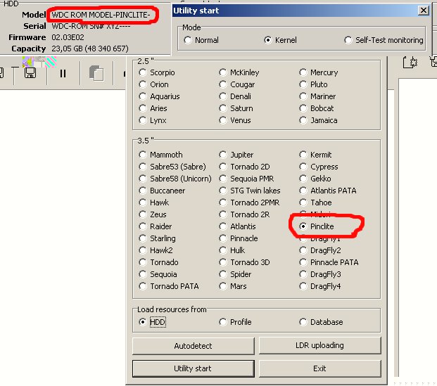

Hi Roustam
Actually this model autodetects as Pinclite family and not Pinnacle
I just downloaded the latest Pinclite.pcr and there seems to be none from the same family
So, if someone that reads this message have firmware for WD WD800AAJS-xxM0xx f(amily M0) I am still looking for it

Postby -BR- » 10.09.10, 17:47
Hi AJ2008 and databalance
First of all thank you for your interest! :P
Yes, I have read the new WD marvel manual and I am aware of the new #11 method
This hdd detects with wrong ID and capacity (please check screenshot from my previous post above)
Is has the following bad modules (only listed bad modules of importance A, B, C. bad modules of importance D and E were ignored from this list):
