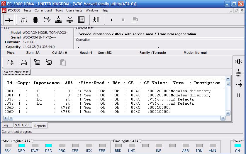

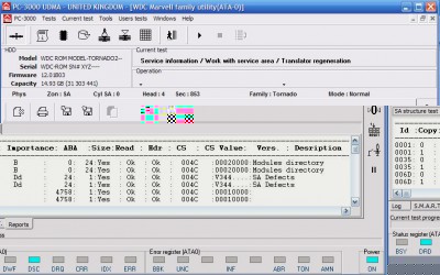

Hi, please excuse me, but I am new to PC3000. This drive was, I thought dead, because I
could not get it to spin up. Using a perfect donor, we tried hot-swap with no luck, but at
least the drive spins up now. But the size and ID are wrong. (see below)
I would like to know how to use the PC3000 UMMA to fix this drive.
I tried to also attach the log and results of SA Structure test, but this app. would not let me.
So, please excuse my long paste:

-----------------SA STRUCTURE TEST-------------------------------------------------------------------------------------------------
Id :Copy: Importance: ABA :Size:Read : Hdr : CS : CS Value: Vers. : Desription
0110: 0 : B : 60122: 24:Yes :Error:Error:0000/00BD:........:Modules directory (base part)
0110: 1 : B : 60122: 24:Yes :Error:Error:0000/00BD:........:Modules directory (base part)
0102: 0 : Dd : 60121: 1:Yes :Error:Error:0000/000B:........:Heads map module image
0102: 1 : Dd : 60121: 1:Yes :Error:Error:0000/000B:........:Heads map module image
0103: 0 : Dd : 60119: 2:Yes :Error:Error:0000/009A:........:ROM adaptives SA images
0103: 1 : Dd : 60119: 2:Yes :Error:Error:0000/009A:........:ROM adaptives SA images
0104: 0 : Dd : 60118: 1:Yes :Error: Ok : 0000 :........:Microprogram version image
0104: 1 : Dd : 60118: 1:Yes :Error: Ok : 0000 :........:Microprogram version image

Cheers,
Chris Lees
WD3200AAJS-40RYA0 shows wrong size.

Re: WD3200AAJS-40RYA0 shows wrong size.
From what I understood, you used a donor PCB.
First of all, can you read ROM from patient PCB in safe mode?
Is so, copy ROM and ROM modules into donor PCB and try again.
Hi, thanks for the info. I backed up the Patient, and then opened
the Donor in Kernel mode. I wrote ROM and Modules to the Donor
card, powered off, swapped cards, and now the Patient reads
Exactly like before, only 14.93GB's, wrong size, Anything I missed?
Sorry, I should have said: I reversed the procedure and rebuilt the Donor
working, so I know my procedure was correct.
Chris
Chris
Hi again,
You got a few damaged modules.
Can you make a resume of what modules can't be read?
Besides that, can you read tracks?
You can try to read the damaged modules in composite, though I am not so sure this is possible with both copies bad. Maybe tracks can be read?
You have problems with G-List, Relcoated Bad Blocks Module, both can be replaced with mods from donor and translator can be regenerated after. HDD ID can also be replaced from same model donor. Some other modules, such as modules related to 'microprogram code' are all related to overlays and if you cannot repair you should write from donor of matching model and firmware, in your case '00210020'.
Alternatively, if you do have access to a donor you may try HotSwap process, this should be a little easier and will not involve writing to and replacing the SA. If you are unsure about what is safe to write to SA then HotSwap will be a better option for you
From the tracks you could check if you have all necessary modules, and if you have a donor, then you could do smart hot swap, as it would be much easier than trying to fix all of them in the patient drive.
