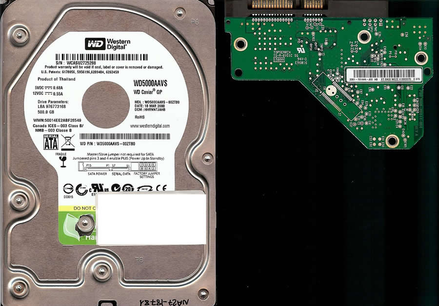

Can anyone tell-me which family can i use to this disk : WD5000AAVS-00ZTB0
I have two disk off this model for datarecovery.
First One it detect all ID serial Model.
Second one dont detect anything. ( FOTO2 )
It gives DRD DSC, think PCB.
ZeBong
WD5000AAVS-00ZTB0
WD5000AAVS-00ZTB0

This drive WD5000AAVS-00ZTB0 correspond to Spider family, but we do not support it. That is why you couldn't work with it.
