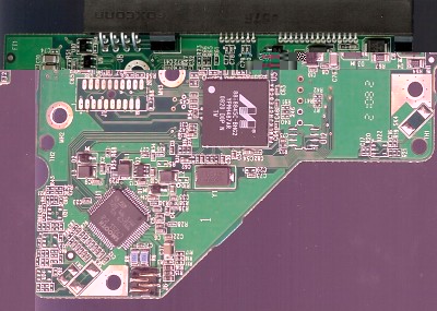

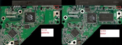

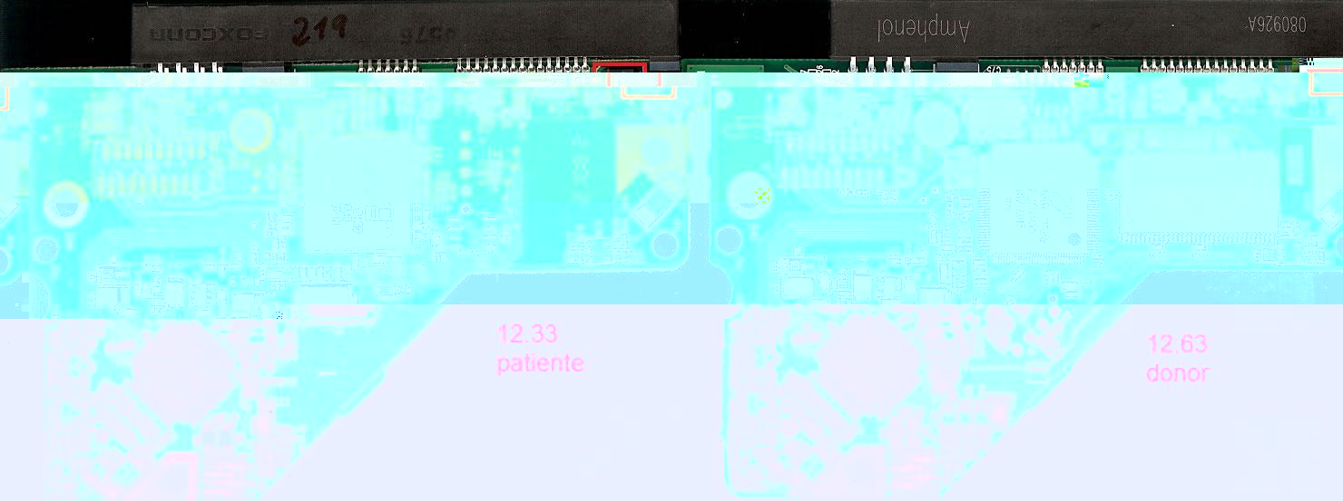

The picture off PCB is this:
Can anyone help-me on the PCB wich should be the problem.

Does disk reach DRD and DSC with donor PCB?
Re: WD1600AAJS
Hi AJ2008,
yes with other PCB the drive get DRD DSC.
it's not 100% compatible because the model is the same wd1600aajs-xxxxxx ( this are different)
i try a hotswap, and i can test heads 100% ok.
So i think the problem is in the PCB, but i can not find it anyhere the disk also is from 17 JUN 2008.

Have you used a multimeter to test the readings of components at top right of PCB?
Also what is full model of WD drive?
Re: WD1600AAJS
no not yet, can you show-me wich component shoul i read from multimiter.

I believe that is a Marvel WD from pinnacle family. I am not sure if this is ROYL, if it is then you can perform ROM restoration via PC3K.
If you have working donor PCB, use your multimeter to test components on both PCBs and verify differences in reading.

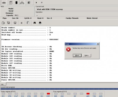

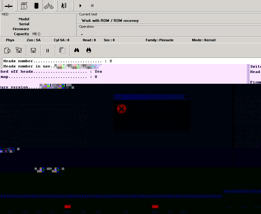

I try to Make a ROM recovery
Happen this :
Then came back to the beggining:

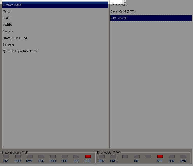

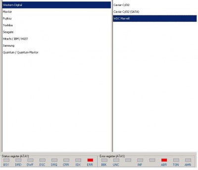

Now the drive when i connect it it give always ATA Erros: ERR ABR
Can not run the utility.
Put the disk in Kernel Mode, and make a ROM Restoration
Them give a error.

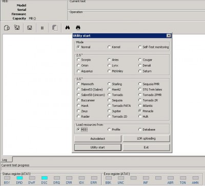

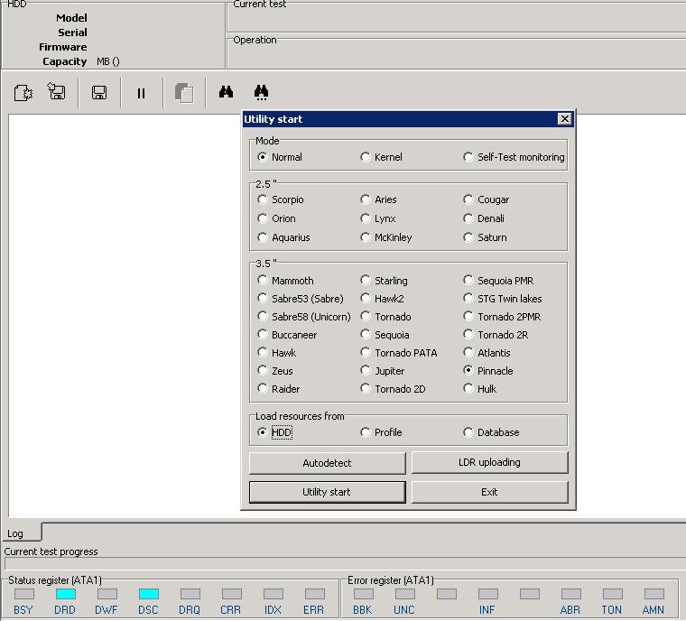

When i power off power on the disk get DRD DSC and i can run it again with the utility but i can not have any ID.
What should i do next ?
Jose
