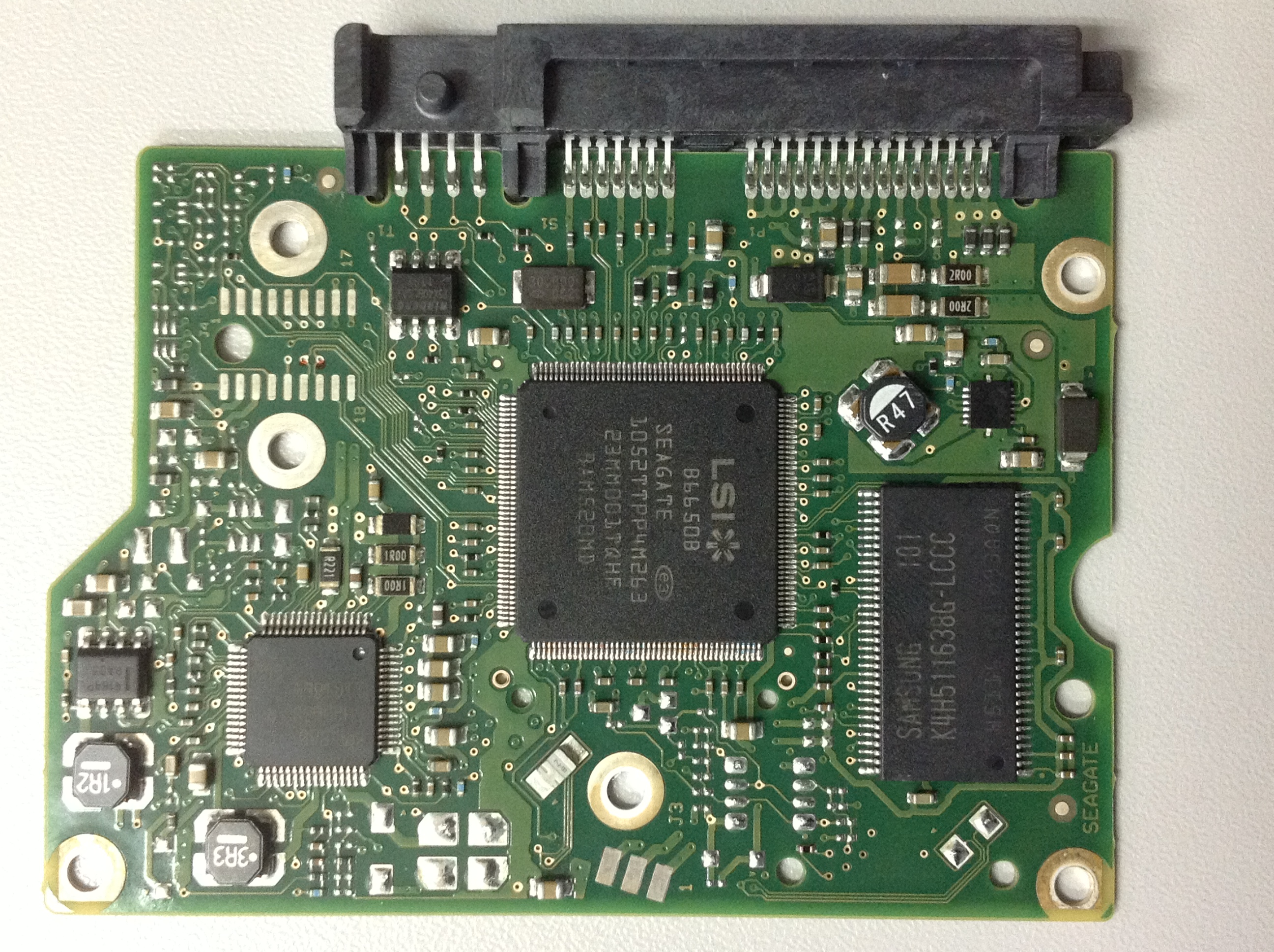

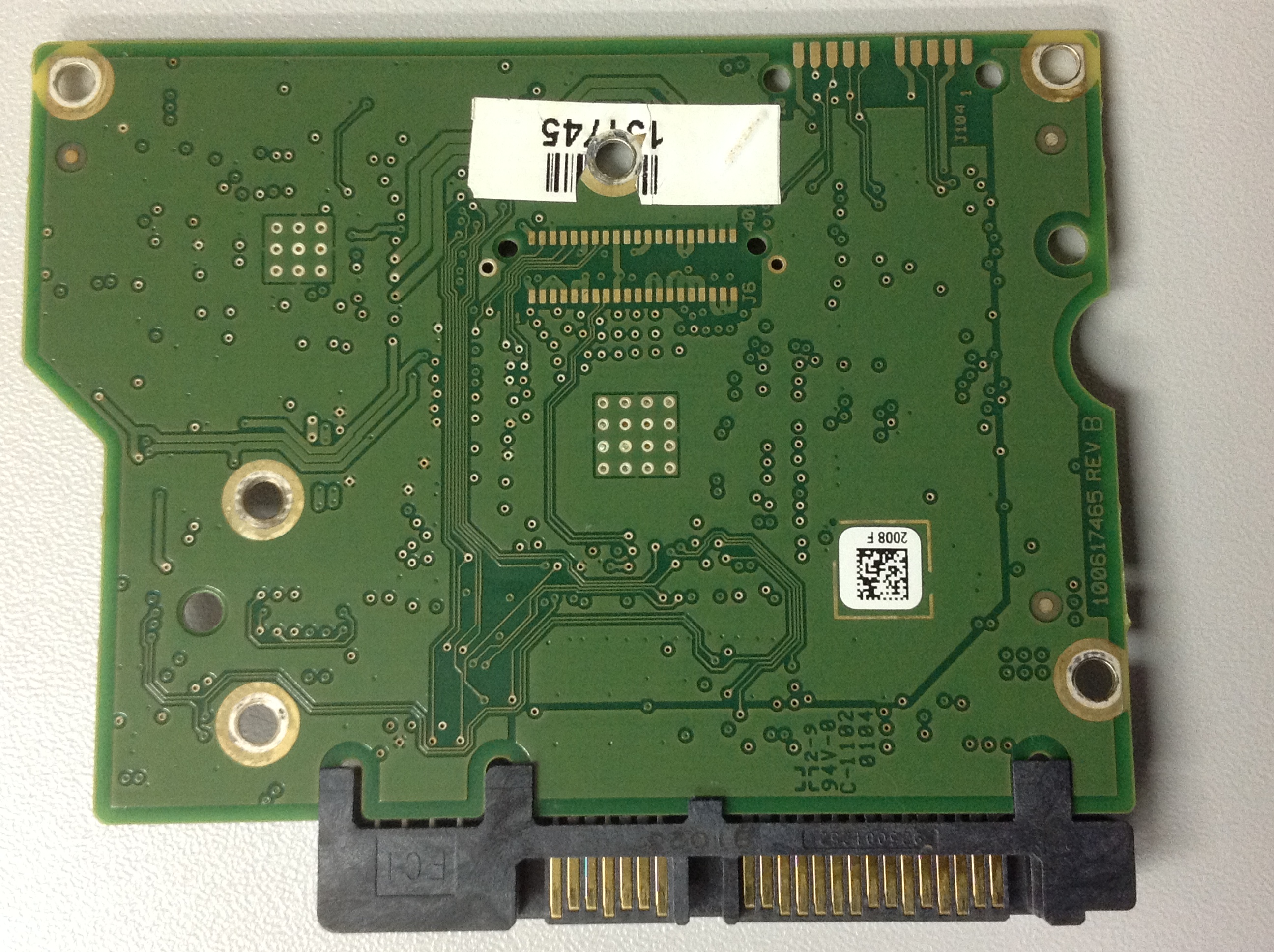

Img of PCB:
Seeking Solution: ST2000DL003 - BSY AND PCB alone not answar
