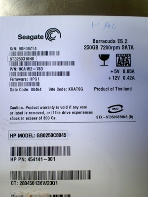

Pablo
Posts: 40
Joined: 03.02.09
Re: ST3500320NS Barracuda ES.2 staying busy
Postby Pablo » 23.04.09, 12:09
There's a picture of disk label.
This is an HP's PC internal disk, and have Hp firmware (HPG1) and own Hp parameters.
steven
Posts: 145
Joined: 25.03.09
Postby steven » 24.04.09, 09:18
first time see Drive with Double iD....
