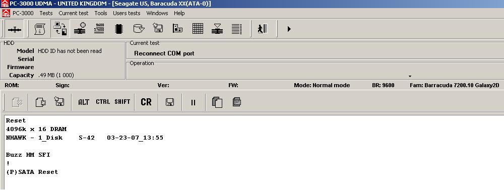

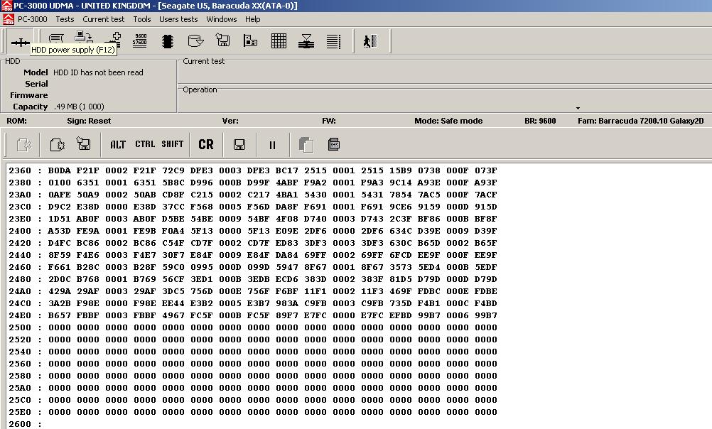

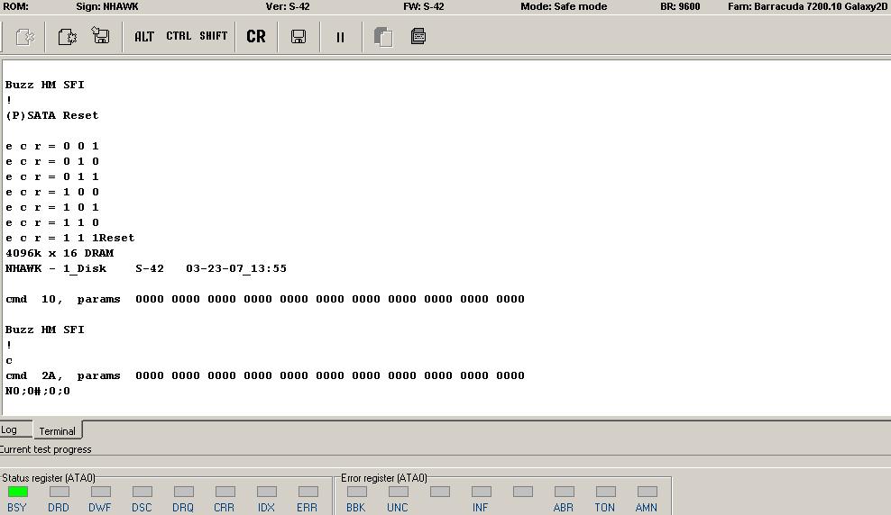

Hi Igor,
Sorry for the late reply. I have attached 3 images of the Terminal. This is usually what you get when you power on
, but if you power of and on again a few times this is what sometimes comes up in the terminal window
and this continues to scroll and finishes here

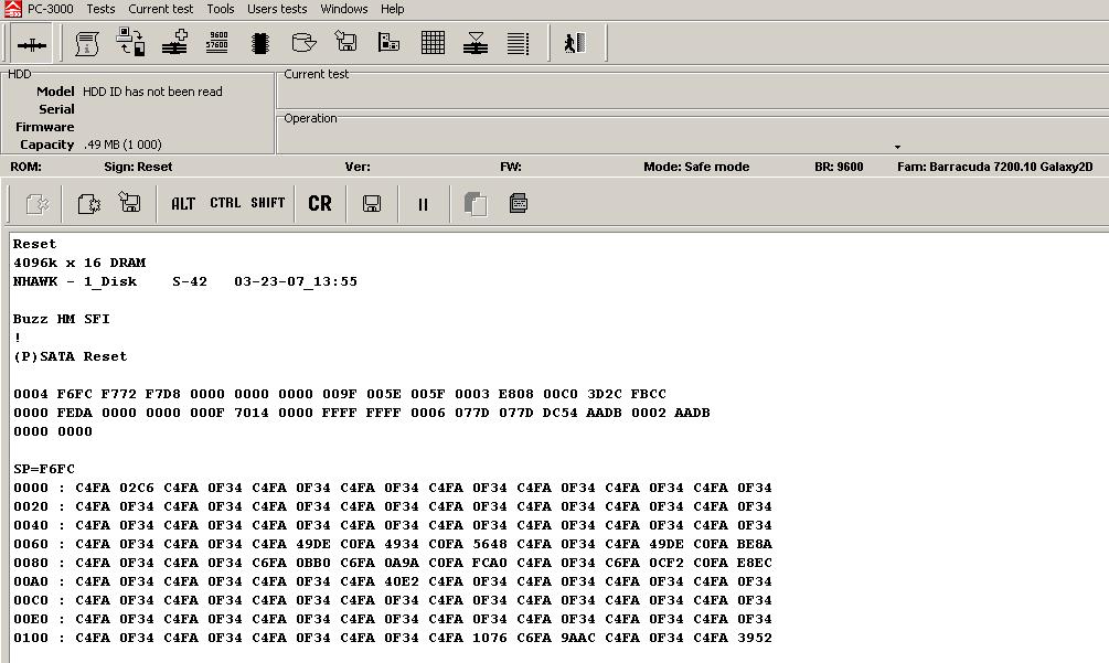

Postby Igor » 25.08.11, 17:02
Press CTRL+D several times while you will see ecr 111
Then press CTRL+C
Paste here log.

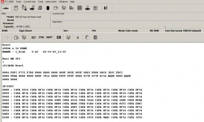

Postby EADR » 26.08.11, 09:18
Hi Igor,
Terminal output as requested...
thanks for your time on this...
