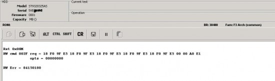

Have this error in terminal
The disk show FW not complet and also size 0
Code: Select all
Rst 0x08M
RW cmd 002F req = 18 F0 9F E5 18 F0 9F E5 18 F0 9F E5 18 F0 9F E5 18 F0 9F E5 00 00 A0 E1
            opts = 00000000
RW Err = 84150180
I could get the disk one time and it show this.
Can you please tell-me the next steps to resolve this issue.

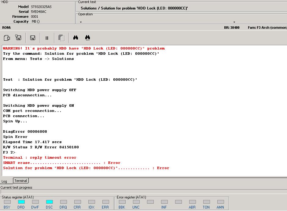

Try to run the script HDD Lock
Put the paper in the red box
Them Give-me this error.
DiagError 00006008
Spin Error
Elapsed Time 17.417 secs
R/W Status 2 R/W Error 84150180
F3 2>

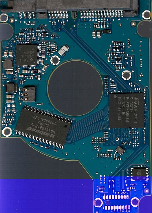

The PCB have this chip.

When i try to go to C to the list the command from the disk
it give-me this:
Rst 0x08M
opts = 00000000
RW Err = 84150180
ASCII Diag mode
F3 T>/C
F3 C>Q
LED:000000CC FAddr:00259A1D

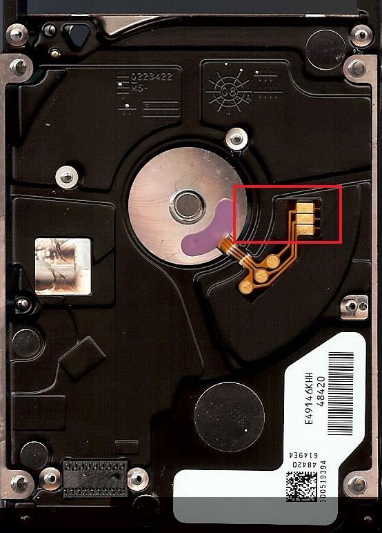

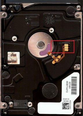

1. Check the drive in clean room for head stuck and platter scratches
2. Get a donor drive and test the spindle motor and commutator contacts with multimeter(you can compare patient's values with donor's). If spindle motor dies-platter swap is the way.Change whole head stack for bad commutator.
3. If the heads stack and spindle motor are good, then you may try to resolder the NV-Ram chip. It is the 8-pin chip with 25U42xxxxx signature. You can see it in the right bottom corner on st2.jpg .
